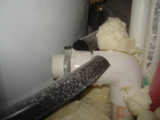

Erby Posted October 28, 2007 Report Share Posted October 28, 2007 And here's how you stick a drain into the drain pan in a brand new modular home! Image Insert: 39.61 KB Image Insert: 26.14 KB Quote Link to comment Share on other sites More sharing options...
Terence McCann Posted October 28, 2007 Report Share Posted October 28, 2007 Great pic Erby. Ifin it don't fit apply more pressure (and apply a lot of Great Stuff so the water doesn't run to the floor below). Quote Link to comment Share on other sites More sharing options...
