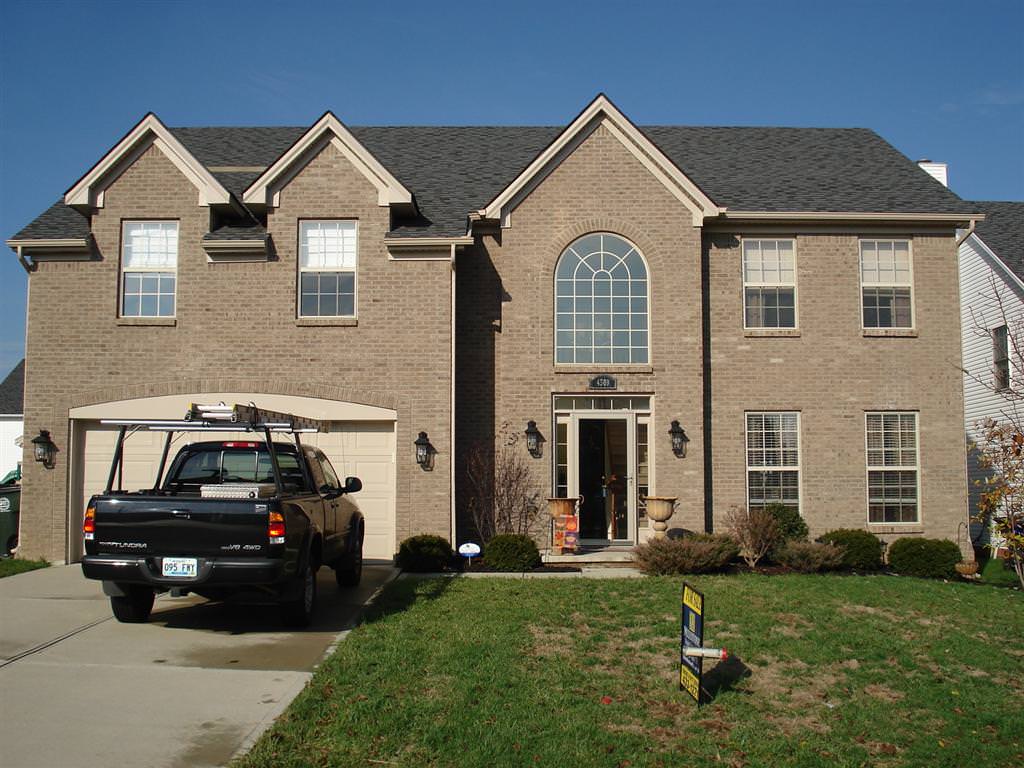

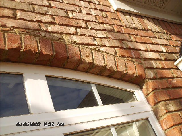

Phillip Posted December 10, 2007 Report Share Posted December 10, 2007 How long will it last before it starts cracking? Image Insert: 137.95 KB Image Insert: 145.74 KB And here is the slope of the bricks at the bottom of some of the windows. Image Insert: 85.56 KB Quote Link to comment Share on other sites More sharing options...
Phillip Posted December 11, 2007 Author Report Share Posted December 11, 2007 I am talking about the bricks and mortar above the window. Quote Link to comment Share on other sites More sharing options...
Bain Posted December 11, 2007 Report Share Posted December 11, 2007 They should be fine if they were installed correctly, Phillip. The arch above the window obviates the need for a lintel. Quote Link to comment Share on other sites More sharing options...
kurt Posted December 11, 2007 Report Share Posted December 11, 2007 I wouldn't be surprised if the brick arch never cracked; maybe a teeny tiny little shift as it finds itself, but not much else. The rowlock sill will probably fall apart in a couple years. Quote Link to comment Share on other sites More sharing options...
Phillip Posted December 11, 2007 Author Report Share Posted December 11, 2007 Most of the windows that I see with that arch has a lintel. Which I informed my client along with the fact that the bottom bricks where not slope as they needed to be. The front door has the same arch and there are cracks in the mortar joints. The house is 5 years old. Quote Link to comment Share on other sites More sharing options...
kurt Posted December 11, 2007 Report Share Posted December 11, 2007 Not sure how an opening can have both an arch and a lintel(?). Quote Link to comment Share on other sites More sharing options...

Les Posted December 11, 2007 Report Share Posted December 11, 2007 I am a firm believer in doing things "right" and being able to cite reputable sources as needed. That said, I likely would have commented on the arch and its construction. Jim K has a good point with his lateral question. Kurt's response may be a little too practical. All things being equal, the arch will still be in place in several years, but cracked. If it is cracked and settled, then how would an inspector explain it? First thing I would investigate is the alignment of arch anchor bricks with the field brick. It is my opinion, Phillip rightly brought the issue into the inspection. Quote Link to comment Share on other sites More sharing options...
