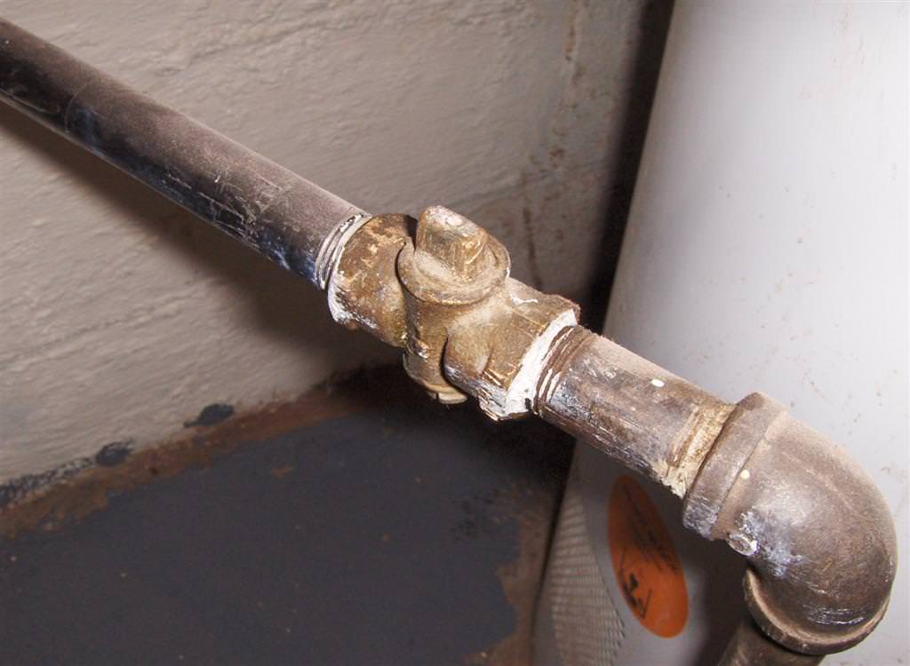

John Dirks Jr Posted April 13, 2008 Report Share Posted April 13, 2008 Does the shut off valve have to be operable by hand or is this type ok? Image Insert: 87.48 KB Link to comment Share on other sites More sharing options...
Jim Katen Posted April 13, 2008 Report Share Posted April 13, 2008 Originally posted by AHI Does the shut off valve have to be operable by hand or is this type ok? I'm not aware of any rule that it has to be hand-operable. - Jim Katen, Oregon Link to comment Share on other sites More sharing options...
inspect4u Posted April 13, 2008 Report Share Posted April 13, 2008 Section G2419 (409) in the IRC covers gas shutoff valves. It doesn't say anything about how they are to be operated, only readily accessible. Mike M Link to comment Share on other sites More sharing options...
