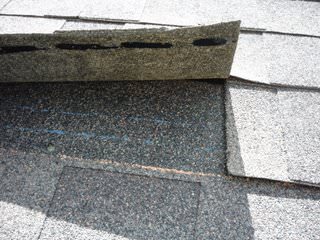

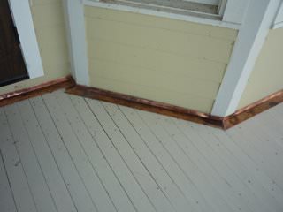

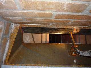

charlieb Posted June 20, 2008 Report Share Posted June 20, 2008 Originally posted by Brandon Whitmore Charlie, While researching this, I remember some granite expert writing that the max. is 8" for 3cm. (based on memory). It sounded like he was basing this on the Marble Institute standards, and mentioned ASTM standards-- I wish I had the link or remembered where I read this. Other guys on the forum were saying the max. was 12" when he cut in with specifics. I hunted and read quite a bit a year or so ago but had nothing to hang my comments on. I did a McManson 2 weeks ago with granite. There was a crack in the island top that was perpendicular to the overhang. The unsupported depth was 14". It was a real piece of work. I spent an additional 5 hours on the report once I left the site. Wind and water entry. The roof was a tear off and the siding should have been but I got the feeling the buyer wasn't going to push things that far. Mr. & Mrs. ATTY closed and moved in about 6 weeks before it was "complete" and the builder lived next door. "But our kids play together". This is their dream home. Provisions were in place for an elevator. They intend to die in the house. Image Insert: 27.94 KB Image Insert: 38.72 KB Image Insert: 20.33 KB Ignore the siding. Look at the EDPM Image Insert: 30.14 KB Any one ever seen a smoke chamber like this? Image Insert: 21.73 KB Image Insert: 33.63 KB Image Insert: 19.09 KB Quote Link to comment Share on other sites More sharing options...
