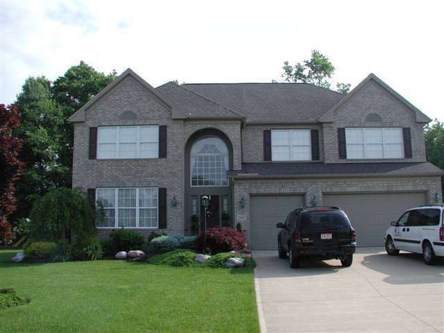

Terence McCann Posted June 8, 2004 Report Share Posted June 8, 2004 Should you expect to find weep holes on this type of face? This was a type of cultured brick, the rest of the home was vinyl sided. Thanks in advance. Download Attachment: 1.jpg 44.11 KB Quote Link to comment Share on other sites More sharing options...
hausdok Posted June 8, 2004 Report Share Posted June 8, 2004 Hi Terry, I'm not sure what you mean by "cultured" brick. Do you mean that the bricks are all concrete bricks of different colors made to look like clay brick? Was it a full-concrete veneer that has had a brick coursing pattern cut into. Or, was it a faux brick facing adhered to a bed or Portland cement over extruded wire lath and then struck to look like full-depth brick? If it is a full brick veneer it needs weeps and through-wall flashings. If a concrete face over lath or faux bricks set into a bed over lath, it should be done like veneer and be clear of the soil and any flatwork so it can drain from behind. ONE TEAM - ONE FIGHT!!! Mike Quote Link to comment Share on other sites More sharing options...

kurt Posted June 9, 2004 Report Share Posted June 9, 2004 I'm with Mike; what is "cultured brick"? I'm assuming that you mean those soft brick that are adhered to a fibrous/celotex substrate. They don't need weepholes. If it is a "real" brick veneer sitting on a brick shelf on the foundation, you needs weepholes, wicks, & through wall flashing. Quote Link to comment Share on other sites More sharing options...

Terence McCann Posted June 9, 2004 Author Report Share Posted June 9, 2004 Mike stated: Do you mean that the bricks are all concrete bricks of different colors made to look like clay brick? Bingo, its construction is similar to that of the cultured stone. Googled it and found a bunch of info. Thanks guys! Quote Link to comment Share on other sites More sharing options...

n/a26 Posted June 10, 2004 Report Share Posted June 10, 2004 Originally posted by DLRambo In Kansas City you don't see weep holes in the brick - maybe its too expensive. Dan Bowers I inspect new construction in Southern KCMO area and ALL brick veneer must have weep holes. I won't pass a home for occupancy without them. Without weep holes, you have not only the potential for moisture problems and rot, but eventually it "WILL" happen. There has to be a way for that moisture to leave from behind the brick veneer. Weep holes and wicks are dirt cheap. Cheaper than the home depot price quoted above. Cost is not an issue anyway, especially when faced with the potentials of NOT having them. If weep holes are not installed on a home, it is usually due to poor quality build work, not due to being cost prohibitive. Quote Link to comment Share on other sites More sharing options...
Konrad Posted June 10, 2004 Report Share Posted June 10, 2004 Slight thread drift, but... During the final stages of construction on the commercial side the finish grade guy will come in with black dirt and a box scraper and sometimes finish the grade above the brick course with the weep holes in it. A hole in the brick just inches below the surface is asking for water to go into the wall cavity. Keep them weeps above the finish grade. [b)] Quote Link to comment Share on other sites More sharing options...
Amn Posted January 17, 2005 Report Share Posted January 17, 2005 Some comments: First, regardless of what type of brick or masonry that you have, if you have an airspace, or cavity behind the veneer, then you need weepholes at the masonry sill, opening head/sills, etc. Second, assuming that there is a good through-wall flashing installed, a little water temporarily in the weep holes is no problem as long as the water level does not rise above the top of the flashing (and assuming that the flashing is not compromised). Of course, weep holes beneath grade level are not a good idea in any case. A Quote Link to comment Share on other sites More sharing options...
