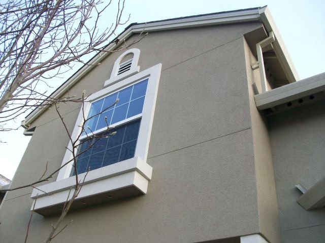

Brandon Whitmore Posted February 11, 2009 Report Share Posted February 11, 2009 Question for all of the local Oregon inspectors. I have a job coming up on Thursday in Orenco Station (Hillsboro) on a townhouse built in 2001. I was told that the stucco has been recently replaced throughout the complex because of a bunch of problems. Can any of you provide me with any info. regarding this? Here's a picture. Click to Enlarge 52.43 KB I am also curious as to whether it is true stucco or synthetic. Also, do any of you the name of a good stucco inspector in the area-- the Realtor wants me to refer one to him. I used to recommend Siding Solutions Inc.-- are they a good choice? Thanks, Quote Link to comment Share on other sites More sharing options...
SWagar Posted February 11, 2009 Report Share Posted February 11, 2009 Brandon, From what I know, it is all EIFS. I've seen a couple that were under repair, what a mess! Some of the owners are being assessed a large sum as part of the siding replacement and rot repair. Not all of the units have been replaced yet. Bring your EIFS hard hat! Siding Solutions is still the EIFS firm I recommend. Quote Link to comment Share on other sites More sharing options...
hausdok Posted February 11, 2009 Report Share Posted February 11, 2009 Looks like EIFS; not a control joint or accessory joint anywhere to be seen in that photo. Then again, there aren't any large areas visible where you'd need such joints with 3-coat. OT - OF!!! M. Quote Link to comment Share on other sites More sharing options...

Brandon Whitmore Posted February 11, 2009 Author Report Share Posted February 11, 2009 Scott-- Thanks for the info. Mike-- I blew up the picture and it almost looks like some control joints at the tops of the windows, but it's hard to tell. The RMLS listing has it listed as: Stucco. Reminds me of the listing agent on my inspection last week that listed her personal house as fiber cement lap. Most of it was LP lap, with some fiber cement repairs............ hmmmmmm.... Quote Link to comment Share on other sites More sharing options...

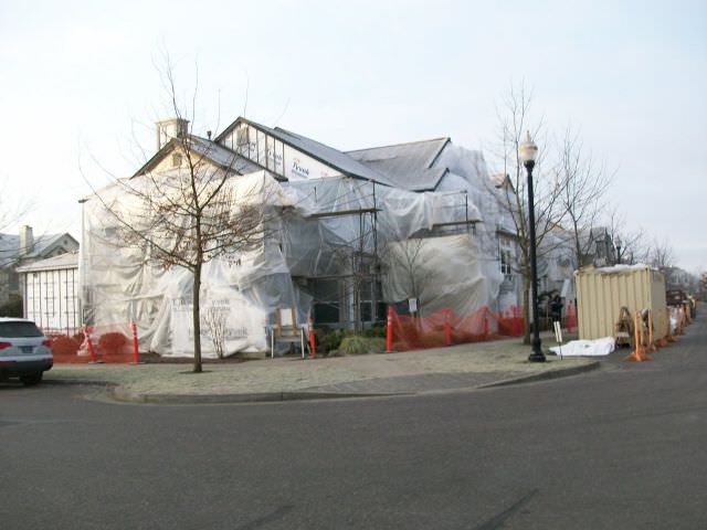

Brandon Whitmore Posted February 12, 2009 Author Report Share Posted February 12, 2009 Well, the siding turned out to be true stucco siding with EIFS accents. It looks like they originally had EIFS installed. Here's a picture of the house across the street (one of many being worked on right now): Click to Enlarge 45.54 KB Here's a picture of base of the wall. How big of a deal would you all make of the felt paper not being properly lapped over the weep screed?: Click to Enlarge 54.55 KB Here's the expansion joints: Click to Enlarge 57.46 KB Quote Link to comment Share on other sites More sharing options...

Brandon Whitmore Posted February 12, 2009 Author Report Share Posted February 12, 2009 I could have walked through this neighborhood all day just looking at all of the screw ups, and what they have caused. I had trouble finding a parking spot anywhere, and had trouble driving down the streets due to all of the laborers walking around. What a mess. Quote Link to comment Share on other sites More sharing options...
