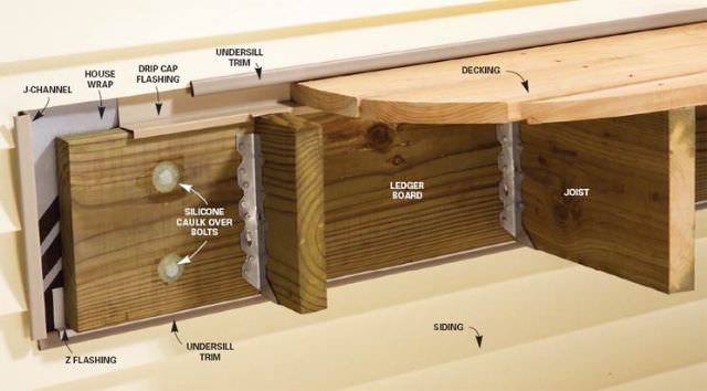

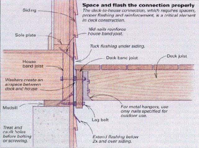

hausdok Posted November 23, 2009 Report Share Posted November 23, 2009 Flashing should have been on top. To catch the water before it goes behind the ledger. Well yeah, unless they're doing something like this: Click to Enlarge 79.86 KB or this: Click to Enlarge 34.81 KB ONE TEAM - ONE FIGHT!!! Mike Quote Link to comment Share on other sites More sharing options...
Erik Posted November 23, 2009 Report Share Posted November 23, 2009 Mike, I am not a fan of your first diagram I don't now how many times I have seen the space between the flashing and ledger full of Leafs. Allowing the moisture to accumulate and rot the ledger. Second one I what I like to see. Nevertheless from what I can see in the picture. I don't like the fact that the OSB is setting or in contact with the concrete foundation. But it appears the water is coming from the behind the flashing. I would look to see if the flashing was installed properly. If it is start looking at roof, window, and door terminations. I have seen OSB exposed under a deck that was flashed properly and it was fine by the time I got to inspect it twenty years after it was installed. I don't think the fact the OSB is exposed would be why it rotted. Something else is going on. Quote Link to comment Share on other sites More sharing options...
