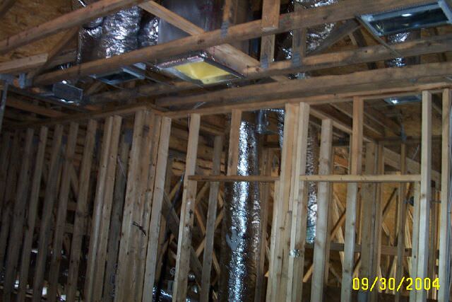

Danny Pritchard Posted September 30, 2004 Report Share Posted September 30, 2004 I saw this today.Three supply ducts and one return duct.Behind the return duct is a closet for a gas forced air heater.No provisions have been made as yet to supply the heater with makeup air.I would think when they sheetrock they will place a grill in the wall for the added air.The closet backs up to the attic where this could be done. I question the location of the supply next to the return duct and is the return duct too close to the closet where it could affect the makeup air? Download Attachment: Gas heater by RA0002.jpg 89.15 KB Quote Link to comment Share on other sites More sharing options...
crusty Posted September 30, 2004 Report Share Posted September 30, 2004 New construction under most if not all building codes requires fresh air intake for combustion and ventilation of the enclosure. Check your local codes for the exact required configuration. Quote Link to comment Share on other sites More sharing options...
aaron Posted October 18, 2004 Report Share Posted October 18, 2004 Hello, The supply and return are definately too close to each other. Some separation is needed to allow the heat to properly cycle through the room. This will only allow the heated air to be drawn back into the return. Defeating the purpose. I would like to see how this will be finally finished. As for the water heater makeup air. There is not enough information. You need to know where the opening for the make up air is going to be located. You might want to make a note in your report telling the buyer to check whether or not the make up air opening is installed and how it is installed. Aaron Flook A-Z Tech Home Inspections Quote Link to comment Share on other sites More sharing options...
