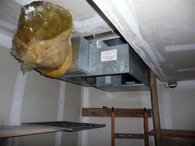

Robert Jones Posted December 31, 2009 Report Share Posted December 31, 2009 Home was built in 1987 and that this unit installed in the garage. The home was heated via electric ceiling radiant strips. I was not able to get the Nutone to turn on and just figured via appearance that it was out of commission. Is an air to air heat exchanger another way to fluctuate the air within the home? First one of these for me. I am not sure if I should call it out or what. T Click to Enlarge 40.95 KB Click to Enlarge 58.06 KBhanks. Quote Link to comment Share on other sites More sharing options...
Jim Katen Posted December 31, 2009 Report Share Posted December 31, 2009 That's an ancient heat recovery ventilator. It's supposed to take some indoor air and blow it outside while, at the same time, taking some outdoor air and blowing it inside. As the air streams pass each other, they warmer stream gives up its heat to the cooler stream so that the ventilation doesn't increase the load on the heating or cooling system. There are usually filters in there that no one knows are supposed to be cleaned. After 20+ years, they're probably completely occluded. If it doesn't work, someone ought to come out and fix it. - Jim Katen, Oregon Quote Link to comment Share on other sites More sharing options...
Robert Jones Posted December 31, 2009 Author Report Share Posted December 31, 2009 Thanks Jim. There were filters(kinda) and a round disc looking thingy that were filthy. I will recommend a service call by a HVAC tech. Thanks again. Quote Link to comment Share on other sites More sharing options...
Jim Katen Posted December 31, 2009 Report Share Posted December 31, 2009 Thanks Jim. There were filters(kinda) and a round disc looking thingy that were filthy. I will recommend a service call by a HVAC tech. Thanks again. The round disc is the rotary core. There are two basic types of HRV, rotary core and fixed plate. The rotary core versions were supposed to be more efficient at transferring heat and they were capable of transferring some humidity as well. However, every one I've ever seen wasn't working properly. The fixed core ones that I see are generally in pretty good shape, except for being dirty. If you have access to the JLC archives, there was a good article about them in March of 1994. - Jim Katen, Oregon Quote Link to comment Share on other sites More sharing options...
