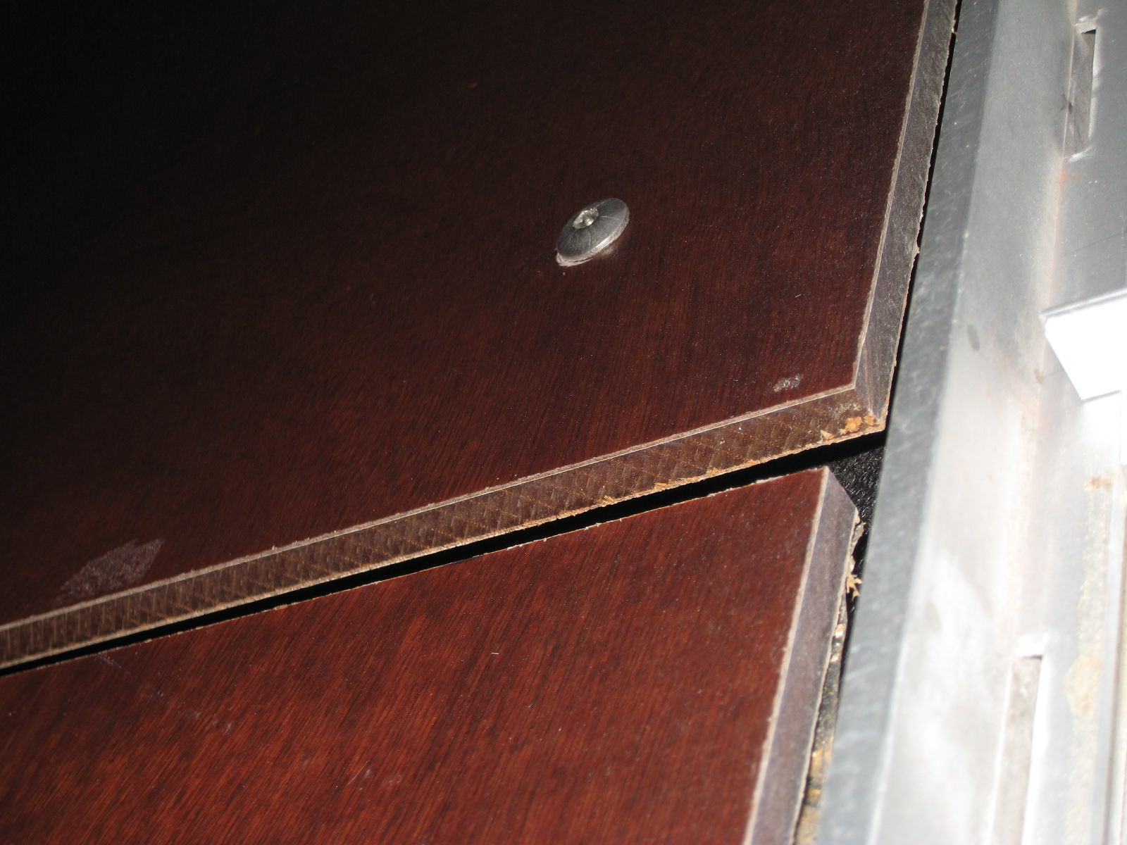

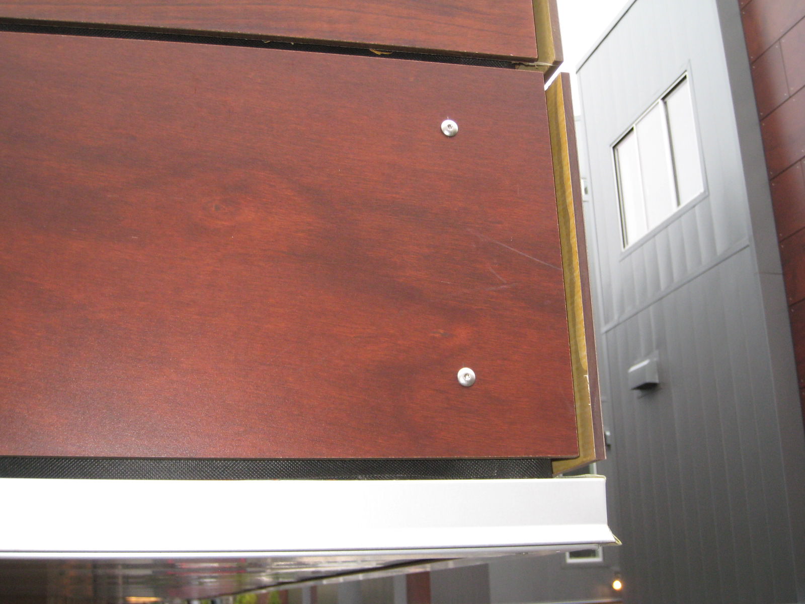

exploreparadise2 Posted February 3, 2010 Report Share Posted February 3, 2010 Does anyone know the manufacturer of this siding, or what it should be called? They're exterior panels on a rain screen system. The panels are laminates with a wood grain exterior. The middle sections looks like a plastic composite. Download Attachment: IMG_8386.JPG 480.62 KB Download Attachment: IMG_8413.JPG 459.37 KB Thanks, Quote Link to comment Share on other sites More sharing options...
Bill Kibbel Posted February 3, 2010 Report Share Posted February 3, 2010 That's a high pressure laminate. Try Googling "Parklex" - the only product of that type that I'm familiar with. Quote Link to comment Share on other sites More sharing options...
Tom Raymond Posted February 3, 2010 Report Share Posted February 3, 2010 Citadel makes numerous panel systems as well, although I think most (if not all) of their skins are aluminum. http://www.citadelap.com/ Tom Quote Link to comment Share on other sites More sharing options...
Robert Jones Posted February 4, 2010 Report Share Posted February 4, 2010 I think Bill might have nailed it. http://www.fincolorply.com/facade.htm# Quote Link to comment Share on other sites More sharing options...
MTL_Inspet_Man Posted February 4, 2010 Report Share Posted February 4, 2010 In technical terms it's actually called wall cladding From the picture it looks like a phenoilc material core with a laminated exterior finish. Phenolic material have a great property of being stable in wet surroundings. Cheers Quote Link to comment Share on other sites More sharing options...
