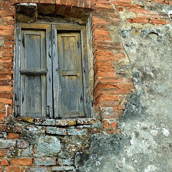

Terence McCann Posted February 25, 2010 Report Share Posted February 25, 2010 But, just think about how good you're going to become at replacing lintels... [:-propell Ok Mrs. Jones, all done. I gave it that distressed look too... Link to comment Share on other sites More sharing options...
mgbinspect Posted February 25, 2010 Report Share Posted February 25, 2010 Saweeet! And, eliminated that pesky* steel lintel in the process... BRILLIANT! [:-graduat * Pesky - Refer to Popeye's dictionary. Link to comment Share on other sites More sharing options...
