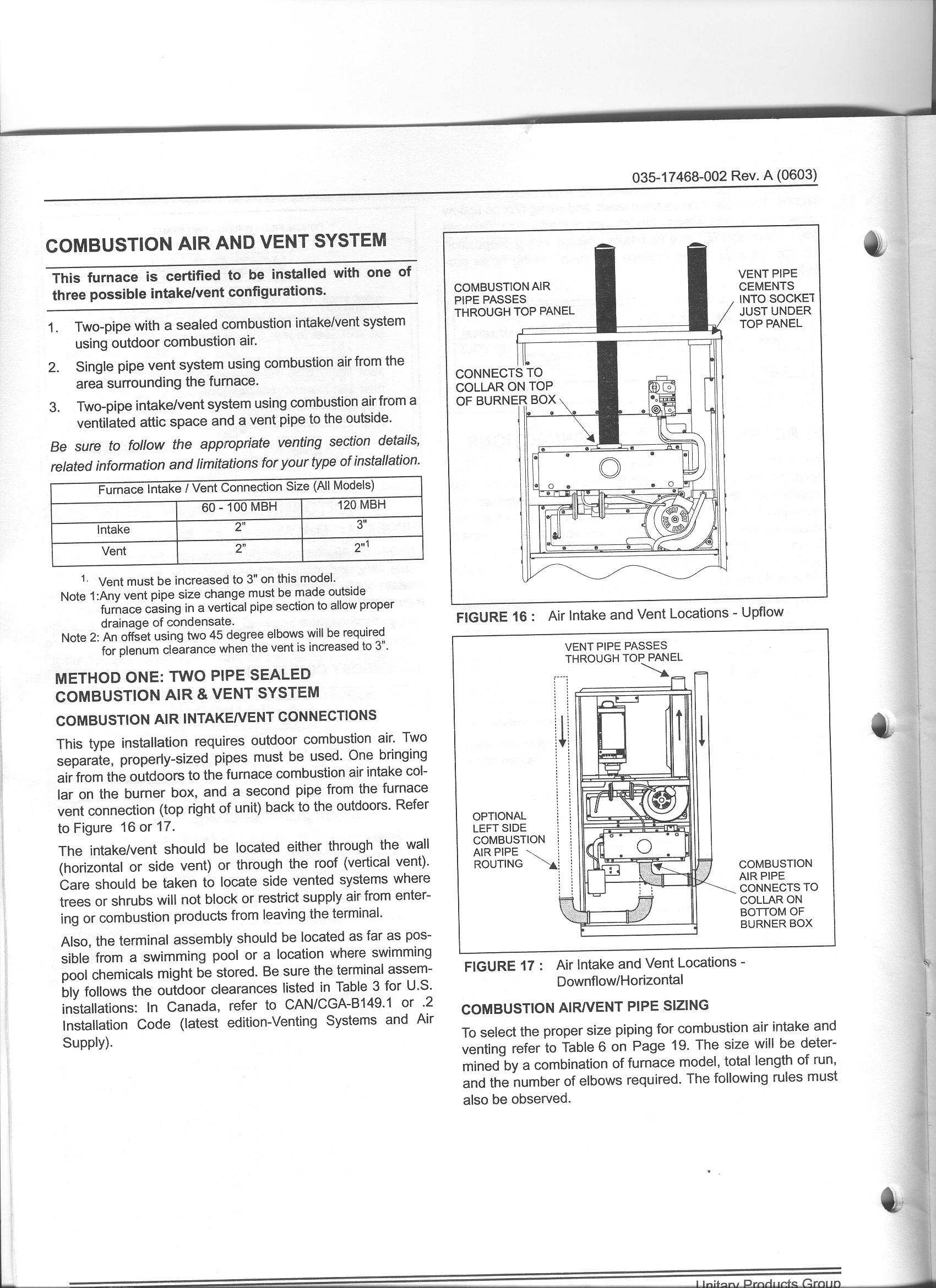

firozhirji Posted March 26, 2010 Author Report Share Posted March 26, 2010 I will try and answer all the replies in here: Tech checked the thermostat. The fault code was 3 but was not produced while the tech was there (like a car problem that disappears as soon as you get to the garage and comes back as soon as you leave the garage!!). The tech checked the pressure switch and checked the blower and ventnor motor. The tech checked all the pipes --including the runoffs for the condensation in the vent pipe. He could only think of the pipes being 2" instead of 3". I have attached the pages from the manual that says 3" pipes are needed for 112 MBT units Download Attachment: page 14 001.jpg 560.01 KB Download Attachment: page 15 001.jpg 754.18 KB Quote Link to comment Share on other sites More sharing options...
Terence McCann Posted March 26, 2010 Report Share Posted March 26, 2010 A fault 3 code is "pressure switch stuck open" Armed with the information in your manual take a look at your installation and see what needs to be done with regards to supply and exhaust piping. Then, if you're skilled, tackle the job. If not the last tech who said the piping needs to be changed sounds like he's on the ball. Start with the obvious first. Good luck! Quote Link to comment Share on other sites More sharing options...
Robert E Lee Posted March 26, 2010 Report Share Posted March 26, 2010 It is my understanding that high efficiency furnaces over 100,000 btu require 3" intake and exhaust, as noted seems like that may be the problem. Quote Link to comment Share on other sites More sharing options...
Marc Posted March 27, 2010 Report Share Posted March 27, 2010 A 3" pipe has more than twice the cross sectional area of a 2". If the spec call for a 3", a 2" would be only 45% of that spec. That's significant. Marc Quote Link to comment Share on other sites More sharing options...
