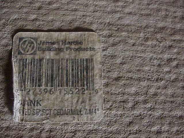

barlyhop Posted April 22, 2010 Report Share Posted April 22, 2010 This siding job looked extremely amateur to me. Hardie Plank Select Cedarmill 7 1/4" lap siding. Many pieces were cut short at window openings and at eaves. 1/16" gaps between butt joints throughout. Existing caulk was opening up all over due to a 1/2" gap at end cuts, etc. I wonder if the installer had a dull sawblade and didn't want to recut short pieces? Does this stuff shrink?? Manufacture does not recommend caulking butt joints. The finish is flaking off at the lower course only on the south side of the house and peculiarly worse behind the gas service? I wonder if the material wasn't primed before painting or the siding was stained as opposed to painting? Hardie recommends 100% latex. The siding was not submerged in water but under snow at times. I now have doubts about using cement fiber siding. Thanks guys! Click to Enlarge 39.88 KB Click to Enlarge 48.69 KB Click to Enlarge 80.02 KB Quote Link to comment Share on other sites More sharing options...

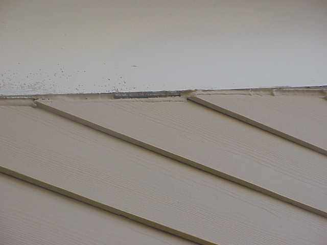

barlyhop Posted April 22, 2010 Author Report Share Posted April 22, 2010 Another siding pic. Click to Enlarge 19.9 KB Quote Link to comment Share on other sites More sharing options...

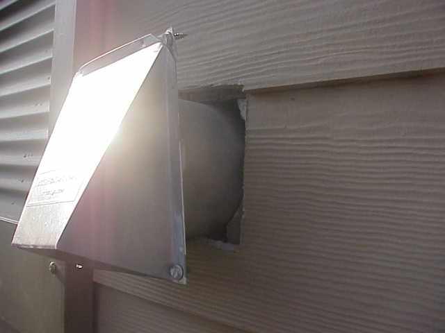

barlyhop Posted April 22, 2010 Author Report Share Posted April 22, 2010 Dryer vent area. Click to Enlarge 22.91 KB Quote Link to comment Share on other sites More sharing options...
Bob White Posted April 22, 2010 Report Share Posted April 22, 2010 Painted while wet? Until I saw the dryer vent, I thought you'd snuck up and taken pics of the siding job we did on the backside of out church building ... Quote Link to comment Share on other sites More sharing options...
Chad Fabry Posted April 22, 2010 Report Share Posted April 22, 2010 Painted while wet with cheap paint; what Bob says. The area below the window is a really, really stupid place to have a joint. The water runs down the window flashing (sic), saturates the unpainted ends of the board and then heat driven vapor moves the paint out of the way as it escapes to atmosphere. I've installed and painted 10's of thousands of square feet of the stuff and I've never seen finish failures like the ones in your photos except where I failed to install a kickout on a balcony on my own home. I installed the kickout, scuffed the board w/ a greenie and painted. It's all good now. Quote Link to comment Share on other sites More sharing options...
hausdok Posted April 22, 2010 Report Share Posted April 22, 2010 I see an awful lot of Hardie fiber-cement products and have yet to see that kind of paint failure; even when the stuff wasn't installed correctly. OT - OF!!! M. Quote Link to comment Share on other sites More sharing options...
Tom Raymond Posted April 22, 2010 Report Share Posted April 22, 2010 That install is nasty, he must have eaten the instructions rather than read them. At the gas meter the siding is way too close to grade. Tom Quote Link to comment Share on other sites More sharing options...
Brandon Whitmore Posted April 22, 2010 Report Share Posted April 22, 2010 I see an awful lot of Hardie fiber-cement products and have yet to see that kind of paint failure; even when the stuff wasn't installed correctly. The only time I run into paint failure similar to that is when the dang painter painted right over dirt. Gotta love new construction painters. Quote Link to comment Share on other sites More sharing options...
Marc Posted April 22, 2010 Report Share Posted April 22, 2010 That install is nasty, he must have eaten the instructions rather than read them. At the gas meter the siding is way too close to grade. Tom I wonder if that is string trimmer damage at the meter. In any case, it's a defective install. Marc Quote Link to comment Share on other sites More sharing options...
Rocon Posted April 22, 2010 Report Share Posted April 22, 2010 I see similar paint failure/damage to painted three coat plaster on a fairly regular basis. The cause is usualy sprinkler heads spraying against the plaster. Quote Link to comment Share on other sites More sharing options...
