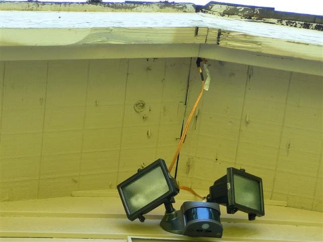

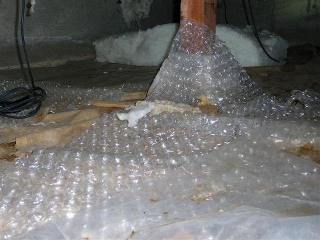

Robert Jones Posted June 12, 2010 Report Share Posted June 12, 2010 This home had to many items to really post about here, but, here are 2 of the better ones. Speaker wire used to run the exterior motion sensor lights(jumped) from a garage outlet. Bubble wrap used as crawl space vapor barrier. Of course this inspection was described to me as "a nice, clean one for you Rob", I think that is the kiss of death. Click to Enlarge 40.38 KB Click to Enlarge 40.92 KB Click to Enlarge 53.48 KB Link to comment Share on other sites More sharing options...
Terence McCann Posted June 13, 2010 Report Share Posted June 13, 2010 Although bubble wrap is certainly unconventional as insulation I wouldn't write it off entirely. I've never given it much thought before your post but I must say that it has piqued my curiosity. You don't breath in any nasty $hit and air is a good insulator. I'd need one of those folks with the pocket protectors. EDIT: From a quick Google search: Bubble wrap has an R-value of about 2. Still an interesting subject. Link to comment Share on other sites More sharing options...
Robert Jones Posted June 13, 2010 Author Report Share Posted June 13, 2010 Well considering it is not being used an insulation but as a vapor barrier, I guess plastic is plastic right? I was thinking maybe it was a cheap way to scare off rats since they were prevelant in this crawl as well;) I will say this, it was comfortable, and noisy! Link to comment Share on other sites More sharing options...

Brandon Whitmore Posted June 13, 2010 Report Share Posted June 13, 2010 Bubble wrap has an R-value of about 2. I've heard of people sticking bubble wrap to single paned windows for the added energy efficiency. Link to comment Share on other sites More sharing options...
mthomas1 Posted June 13, 2010 Report Share Posted June 13, 2010 1) The bubbles go flat after a while. 2) Flammable w/ toxic out-gassing. Link to comment Share on other sites More sharing options...

Brandon Whitmore Posted June 14, 2010 Report Share Posted June 14, 2010 2) Flammable w/ toxic out-gassing. As is about everything else placed in a home, during and after construction. Link to comment Share on other sites More sharing options...
