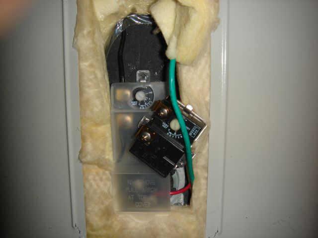

Bain Posted August 19, 2010 Report Share Posted August 19, 2010 I woke up to mostly cold water this morning. I checked the 4-year-old heater and the hi-limit reset button had popped. I reset it, and moved the temperature-control dials to "A", but when I came home for lunch later, the water temperature was nearly 150 degrees. I disconnected power, figuring one or both of the thermostats was shot. When I got home from work, I checked the thermostats for voltage, and didn't find any at the terminals. Since I second-guess myself about stuff like this, I downloaded the manual--see page 32--and realized I'd remembered correctly how to determine if the thermostats were faulty. I suppose I'll replace both thermostats and hope that solves the problem, but I was wondering if there was anything else I should investigate before I spend the $$ on thermostats. http://www.bradfordwhite.com/images/sha ... 04-00A.pdf Quote Link to comment Share on other sites More sharing options...

Scottpat Posted August 20, 2010 Report Share Posted August 20, 2010 Pull the elements and look at them. If they are covered with heavy mineral deposits you might be able to clean them with CLR or white vinegar. They can overheat so to speak and trip the thermostat. My bet is on the lower thermostat and that is has gone bad. I replaced one on my WH and I think it cost around $12 or so. Quote Link to comment Share on other sites More sharing options...
Bain Posted August 20, 2010 Author Report Share Posted August 20, 2010 Pull the elements and look at them. If they are covered with heavy mineral deposits you might be able to clean them with CLR or white vinegar. They can overheat so to speak and trip the thermostat. My bet is on the lower thermostat and that is has gone bad. I replaced one on my WH and I think it cost around $12 or so. I called a plumber friend, this morning, and he also said the lower thermostat is the one that usually fails. But, he also said he always replaces both the upper and the lower to avoid callbacks. Quote Link to comment Share on other sites More sharing options...
Bain Posted August 20, 2010 Author Report Share Posted August 20, 2010 I made it to the plumbing supply joint, after all. The counter guy said the upper thermostat hardly ever goes bad, and that I really only needed the lower one. Nine dollars, three minutes of time, and voila! Problem solved. Click to Enlarge 29.97 KB Quote Link to comment Share on other sites More sharing options...
