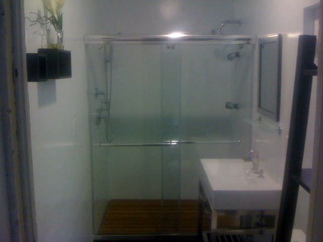

fabwash Posted July 30, 2011 Author Report Share Posted July 30, 2011 Here is the result. The shower pan is standard. There is tile in the pan to make it easy to clean. On top of the tile is a teak mat. The walls are made of: 1) Tar paper 2) Hardibacker 3) 3 coats of the Izonil/Mix waterproof solution 4) 1 coat swimming pool primer 5) 2 coats wimming pool paint Click to Enlarge 27.17 KB Quote Link to comment Share on other sites More sharing options...
Jim Katen Posted August 1, 2011 Report Share Posted August 1, 2011 That looks nice. The teak duckboard is going to collect soap scum, though. If you can lift it out of there easily, you might want to take it out and scrub it down on all sides a couple of times a year. Quote Link to comment Share on other sites More sharing options...
