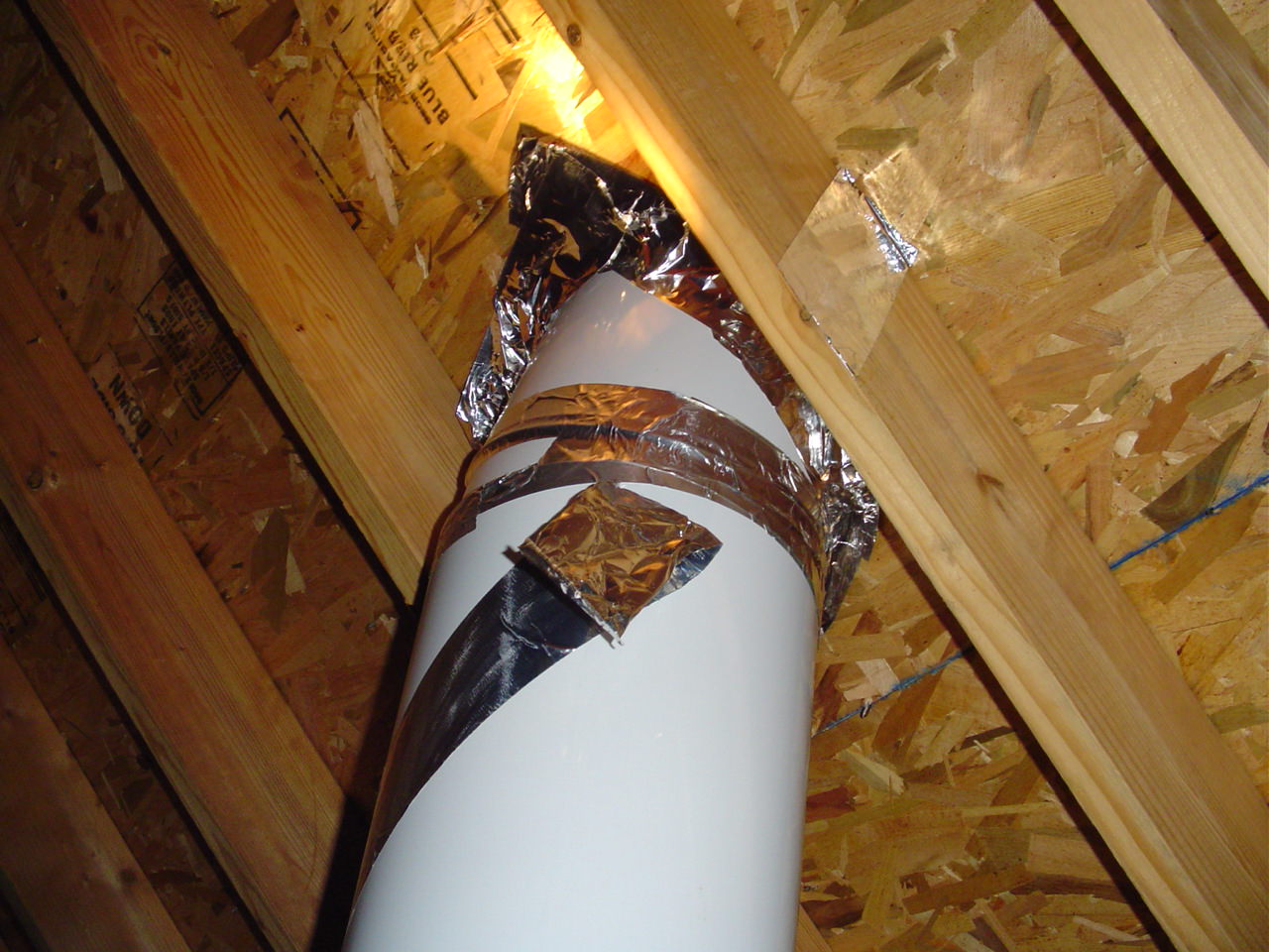

Bain Posted February 8, 2005 Report Share Posted February 8, 2005 The attached photo is of the tubing/housing of a round-lens skylight in a house I checked out yesterday. The housing had no support whatsoever except for a few haphazardly placed strips of duct tape--several pieces of which were partially detached. Does anyone know the proper method of supporting these things? I looked for a manufacturer's label to check them out on the web, but had no luck. John Download Attachment: DSC00882.JPG 606.71 KB Link to comment Share on other sites More sharing options...

Bill Kibbel Posted February 8, 2005 Report Share Posted February 8, 2005 I saw one of these installed by a homeowner, think it was "Solatube". After slammin' it like Kurt, the homeowner handed me the install instructions. The tape is required, but there should be 3 screws at each tube joint. There should also be a suspension wire kit (sold separately but unknown to the home center where it was purchased) that is basically some 16 gauge wire and eye bolts. Link to comment Share on other sites More sharing options...

Bill Kibbel Posted February 8, 2005 Report Share Posted February 8, 2005 John, just found this: www.solatube.com/downloads/install21.pdf Page 5 mentions screwing the tube sections and page 6 shows the suspension wires. Link to comment Share on other sites More sharing options...

chrisprickett Posted February 9, 2005 Report Share Posted February 9, 2005 I have installed nearly 300 Solatubes (was the exclusive dealer for Fiarfield (CT)and Westchester (NY) Counties for about 4 years) Contrary to the bashing by my good buddy Kurt, installed and oriented properly, they are actually pretty good! I never had one leak, and I had three in my own home. The problem is that they are not as easily installed as the manufacturer likes you to think. They come (or did when I installed them) in 10" 16" and 24". A 10" will light a 10'x10' area. Good for a closet, or over a sink. Installed properly, with the dome reflector facing west, they do a great job lighting the room, and have very little heat loss. the biggest screw ups in installing them are: Length of tubing is too long Improper sealing of the tube sections Misorientation of the dome reflector Bad flashing install Link to comment Share on other sites More sharing options...
