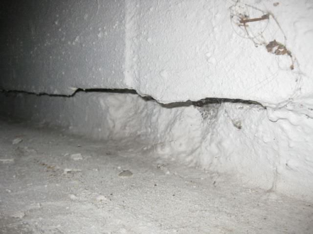

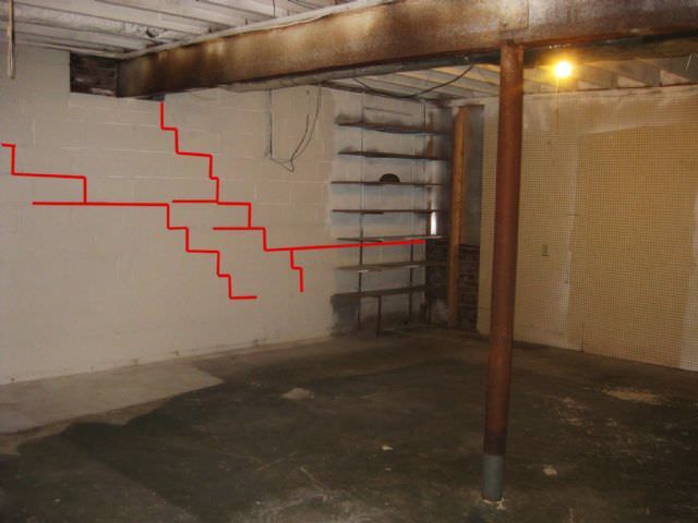

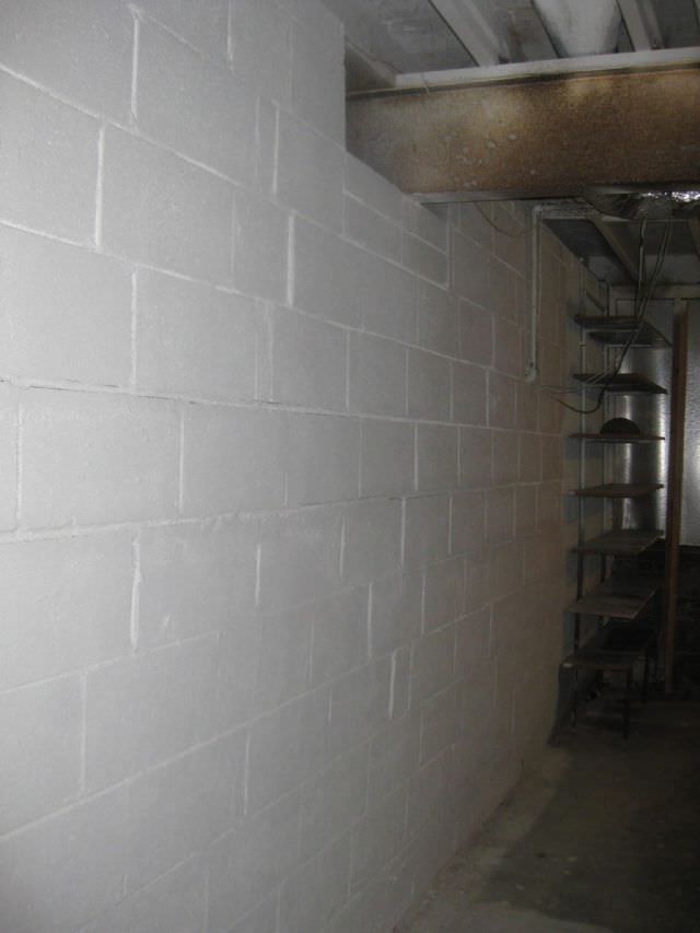

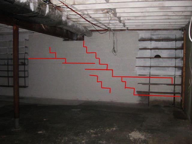

nmccoy08 Posted May 15, 2011 Report Share Posted May 15, 2011 Hi everyone! I just got a home inspection done on a foreclosure that we're under contract with. I'm concerned because one of the basement walls has multiple stair-step cracks and some horizontal cracks in the CMU. There are also some blocks that have vertical cracks that split the block. The house was built in 1973, brick veneer with CMU in the basement. The joists run parallel to the wall with the cracks (it's the short side of the house.) It looks as though there may be some very minimal movement inward of some of the blocks. Also, the brick veneer on the exterior perpandicular wall is cracking close to the corner (can be seen in the picture of the tree.) There's a really huge tree way too close to the wall, which the inspector noted would be the reason for the cracks. Does it seem like there are foundation issues that are causing the cracks? Any information would be very greatly appreciated! I really love the house, but these cracks are making me VERY nervous! I've highlighted where I think I remember the cracks being in red in 2 of the photos. Click to Enlarge 37.93 KB Click to Enlarge 36.11 KB Click to Enlarge 39.64 KB Click to Enlarge 109.45 KB Click to Enlarge 47.35 KB Link to comment Share on other sites More sharing options...
Jim Katen Posted May 15, 2011 Report Share Posted May 15, 2011 Thank you for a very clear explanation and good photos. Are there any cracks in the floor slab? As I understand it, the tree is located on the other side of the right wall in the very first picture, yes? - Jim Katen, Oregon Link to comment Share on other sites More sharing options...
nmccoy08 Posted May 15, 2011 Author Report Share Posted May 15, 2011 Wow, thanks for the quick response! No cracks in the basement floor slab anywhere. The tree is actually directly behind the CMU wall with the cracks (other side of left wall in 1st picture.) Link to comment Share on other sites More sharing options...
Jim Katen Posted May 15, 2011 Report Share Posted May 15, 2011 It would make more sense if the tree were on the right side, but it really doesn't matter. I agree with your inspector. The tree roots have caused your foundation to heave upward slightly at the right side of the picture. I don't think it's a huge problem, but it's certainly something you want to address very, very carefully. If that tree were to fall over during a storm, it could destroy one side of your foundation. Likewise, if some yahoo were to remove it incorrectly, it could cause serious damage. If it were me, I'd cut down the tree one limb at a time until there was just a 6' tall stump left. I'd then trim the stump off at or near grade and poison it with some heavy duty chemicals. I'd want that root system to be dead dead. Then I'd just sit back & wait while the roots slowly decayed over a period of years. - Jim Katen, Oregon Link to comment Share on other sites More sharing options...

nmccoy08 Posted May 15, 2011 Author Report Share Posted May 15, 2011 Thanks for the advise. One other thing I just realized by counting bricks and blocks....it appears as if the step cracks are following the grade. which seems a little odd. Link to comment Share on other sites More sharing options...
Jim Katen Posted May 15, 2011 Report Share Posted May 15, 2011 Thanks for the advise. One other thing I just realized by counting bricks and blocks....it appears as if the step cracks are following the grade. which seems a little odd. It doesn't look that way from the pictures. But if that's the case then, yes, I'd be more inclined to think that the cracks were the result of lateral movement. (Which is worse than heaving.) Either way, either the house or the tree needs to go. Link to comment Share on other sites More sharing options...
nmccoy08 Posted May 15, 2011 Author Report Share Posted May 15, 2011 Another update - I went back to look at the house today with a friend who's a structural engineer. The steps do appear to be following the grade. Also, the tree is located close to the corner of the house (basically behind the shelves in the first picture.) It looks like the first coarse of block is on a concrete curb, and in this area, a few of the blocks have pushed inward by about 2 1/2" (scary.) The wall is definitely bowing inward at the very bottom of the wall. I've attached a picture with a metal tube that is flush against the wall at the top of the wall and the wall is pulled back from the tube by about 2" at the bottom. Click to Enlarge 92.8 KB Click to Enlarge 63.56 KB My friend recommended that the tree be removed, and that we have a steel post installed at the CMU wall under the steel beam to take the load from the steel beam. This should reduce a lot of the lateral load (no tree) and vertical load (no load from the beam.) The roof bears on the long walls of the house so if we installed a post, the only vertical load the wall should have would be from the wood framing and brick veneer from the walls above. I'm going to try and get an estimate from a tree company tomorrow and my realtor's going to try to get an estimate on the post. Here's a picture of the first course of block that has pulled away from the curb below: Click to Enlarge 42.55 KB This is really the worst place at the corner where it looks like one of the blocks is pretty loose: Download Attachment: IMG_0324.JPG 336.44 KB Thanks everyone for the advice! Link to comment Share on other sites More sharing options...
Jim Katen Posted May 15, 2011 Report Share Posted May 15, 2011 If you're going to put a post under that beam, be sure to also put a footing under it. You might want to consider strongbacks or tiebacks to help stabilize that wall. What happened to, "there may be some very minimal movement inward of some of the blocks?" Link to comment Share on other sites More sharing options...
