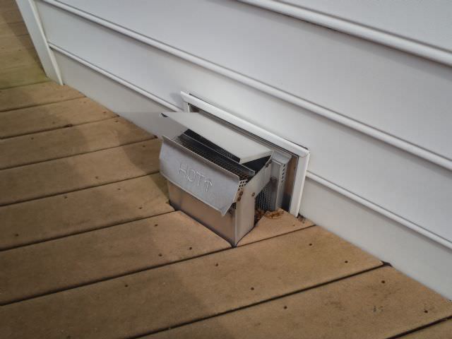

cbass Posted October 4, 2011 Report Share Posted October 4, 2011 Are you guys aware of the clearance requirements for a sidewall flue for a gas fireplace? This is a Trex deck. Thanks in advance. Click to Enlarge 35.18 KB Quote Link to comment Share on other sites More sharing options...
Mike Lamb Posted October 5, 2011 Report Share Posted October 5, 2011 NFPA 12.9.2, 12.9.3. Minimum 12" above finished grade. Quote Link to comment Share on other sites More sharing options...
cbass Posted October 5, 2011 Author Report Share Posted October 5, 2011 No issue being too close to the decking? Quote Link to comment Share on other sites More sharing options...
John Kogel Posted October 5, 2011 Report Share Posted October 5, 2011 A) 12" Clearance above grade, veranda porch, deck or balcony. This is from a Napolean Direct Vent Fireplace installation manual. If you have the make and model, Google search for the manual. That decking is restricting the combustion air intake as well as being too close to the exhaust. Quote Link to comment Share on other sites More sharing options...
Mike Lamb Posted October 5, 2011 Report Share Posted October 5, 2011 I consider the deck to be the finished grade so yes, I would call it an issue. Quote Link to comment Share on other sites More sharing options...

Denray Posted October 7, 2011 Report Share Posted October 7, 2011 Deck was probably added after the flue was there, by the owner. They did a nice job except for the intake and heat thing. [:-taped] What's the problem? It's been that way for months now. Quote Link to comment Share on other sites More sharing options...
