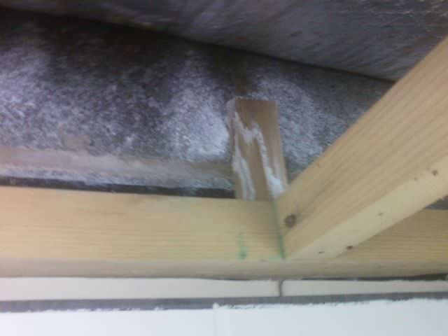

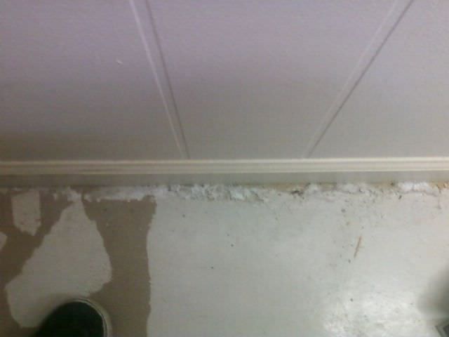

deadtetra Posted January 5, 2012 Report Share Posted January 5, 2012 Hello, I am hoping someone can shed some light on this stuff for me. I don't know what it is, or if I should be concerned about it... I have a basement, split into two sections by a block wall, one half finished, the other half not. On all of the outside walls, white fluffy stuff began appearing several months ago. Curios about it I researched on the internet and learned of efflorescence, and passed it off as such. Although recently I began discovering this stuff in places I wouldn't expect, according to what I've read on efflorescence, from what I gathered it only appears on block of brick. I am finding it on wood studs and rafters, and even on the concrete floor... Is it typical of efflorescence to appear on wood and concrete floors? If not what else could this stuff be? I am concerned although it hasn't appeared to be causing any adverse health effects on my family (although it hasn't been disturbed either). Or am I wrong about this being efflorescence at all? Could this be some kind of mold? One of the pics I attached actually shows the stuff on a wall that is inside (no earth on the other side) which also confused me, I thought efflorescence was cause by moisture draging the minerals in block to the surface of the block, but this is an inside wall that as far as I can tell is always dry... If anyone can shed some light on this for me it would be greatly appreciated. Thank you, -jay Click to Enlarge 46.16?KB Click to Enlarge 30.74?KB Click to Enlarge 72.97?KB Click to Enlarge 21.82?KB Link to comment Share on other sites More sharing options...
Chad Fabry Posted January 5, 2012 Report Share Posted January 5, 2012 If it tastes salty and I bet it does, it's efflorescence. Link to comment Share on other sites More sharing options...
Jim Katen Posted January 5, 2012 Report Share Posted January 5, 2012 It's efflorescence. The moisture moves through the masonry or concrete carrying soluble minerals with it. If there's a piece of wood or drywall touching the masonry or concrete, the water moves through that as well and the minerals build up on the surface where the water evaporates. At your interior wall, the moisture is probably rising up from the floor via capillary action. Link to comment Share on other sites More sharing options...

Jim Katen Posted January 5, 2012 Report Share Posted January 5, 2012 Thanks for the info! I guess my next question then would be, should I be worried that efflorescence is showing up in so many places? The pics I posted is just a fraction of what is actually there, is it a sign of a problem I should resolve or is it perfectly natural? The two are not mutually exclusive. That is, problems are often the result of natural processes. Whether or not it's a problem depends on your expectations. Is this a damp hole-in-the-ground kind of basement or is it something that you fancy to be a finished space? Efflorescence itself causes no harm. It's merely a symptom of water movement. If you'd like to reduce or eliminate the issue, keep the soil around your house dry. To that end, perfect your gutter/downspout/drain system to ensure that every drop of water that lands on your roof gets carried far away from the house. Then alter the grading in your yard so that the soil slopes away from the house. If you irrigate, adjust the distribution and timing of your irrigation cycles to put only the amount of water that you need near the house. Link to comment Share on other sites More sharing options...
Jim Katen Posted January 5, 2012 Report Share Posted January 5, 2012 In one area, yes we've had many problems with leaks and such... In other sections (i.e the wall on the complete opposite side of the basement) I don't recall a leak ever being where this stuff is appearing... That's because this stuff is soluble in water. If there's an actual liquid-water leak going on, the water washes away the efflorescence. In order for you to get the white crystals, the water has to seep through the wall and evaporate at the surface. If the water actually runs down the wall, it takes the minerals with it. At this point I think I'm just going to clean it off and wait to see if it emerges again... There is no change without change. Link to comment Share on other sites More sharing options...
