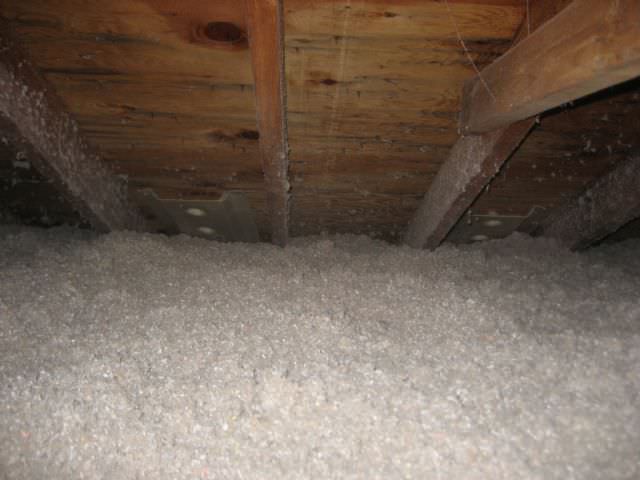

alex3737 Posted March 4, 2012 Author Report Share Posted March 4, 2012 Ok here is a picture of the trouble spot. It is mostly these 3 or 4 bays that get frost. The baffles in those bays don't actually do anything. They don't lead to the outside, just a wall. So you think putting some spray foam insulation in these bays might help, right? Click to Enlarge 46.12 KB Quote Link to comment Share on other sites More sharing options...
Marc Posted March 5, 2012 Report Share Posted March 5, 2012 Ok here is a picture of the trouble spot. It is mostly these 3 or 4 bays that get frost. The baffles in those bays don't actually do anything. They don't lead to the outside, just a wall. So you think putting some spray foam insulation in these bays might help, right? Click to Enlarge 46.12?KB The issue as I had understood you regarded the rafter bays that terminated at a valley rafter. Your picture tells a different story. I'd say you've simply too much moisture in the attic. It comes from the conditioned spaces in the house and should be ventilated to the outside. Ventilation works with the sealing of the attic plane to keep the dew point below the temperature of the roof deck and framing. If there's bath exhaust fans, gas flues or other sources of humidity dumping into the attic, all the air sealing and ventilation in the world isn't going to help. Is there anything at all discharging into the attic? At some point, you may need more attic ventilation. Or you could take an entirely different approach and situate the insulation boundary of the house at the roof plane instead of the ceiling plane but that would waste what you've invested thus far. Marc Quote Link to comment Share on other sites More sharing options...
alex3737 Posted March 5, 2012 Author Report Share Posted March 5, 2012 Sorry if I used the wrong roofing lingo. I'm not sure what you call it where two sections of roof intersect. There's to much snow on the roof right now, otherwise I would get up there and take a picture of what it looks like from the outside. Those particular rafter bays terminate at a wall, where the other part of the house intersects. Those rafter bays have no outside soffit ventilation, even though there are some baffles. Those baffles were put in by mistake. So what you are saying is what the roofing company told me, they said it was a moisture problem and I needed to do air sealing to seal the air leaks so no humid air from the house could get in. So the air seal company came and sealed everything. But the frost was still appearing at only this particular spot in the attic where there is no access to soffit air to ventilate those bays. So the air sealing company told me it was a ventilation issue. So if everything is air sealed, how do you ventilate an area of the attic that doesn't have access to soffit vents? Quote Link to comment Share on other sites More sharing options...

Marc Posted March 5, 2012 Report Share Posted March 5, 2012 Sorry if I used the wrong roofing lingo. I'm not sure what you call it where two sections of roof intersect. There's to much snow on the roof right now, otherwise I would get up there and take a picture of what it looks like from the outside. Those particular rafter bays terminate at a wall, where the other part of the house intersects. Those rafter bays have no outside soffit ventilation, even though there are some baffles. Those baffles were put in by mistake. So what you are saying is what the roofing company told me, they said it was a moisture problem and I needed to do air sealing to seal the air leaks so no humid air from the house could get in. So the air seal company came and sealed everything. But the frost was still appearing at only this particular spot in the attic where there is no access to soffit air to ventilate those bays. So the air sealing company told me it was a ventilation issue. So if everything is air sealed, how do you ventilate an area of the attic that doesn't have access to soffit vents? I can understand how you might be frustrated. This issue, in a Wisconsin climate, CAN be frustrating. I agree with what Bill and Brandon are hinting at...there's a moisture source that's dumping into the attic in the vicinity of the frost areas, in addition to a general need for more ventilation i.e. more soffit venting and something less restrictive than the baffles. Does TIJ have any members within reach of Waukesha? Marc Quote Link to comment Share on other sites More sharing options...

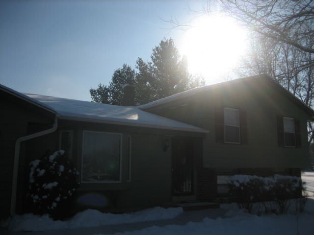

alex3737 Posted March 5, 2012 Author Report Share Posted March 5, 2012 Sorry for the bad quality pic and I can't get on the roof right now to show a better picture, but this will give you a better idea of the roof situation. Where these two roofs meet is where the problem is. There is no open air flow between them. Where these two roofs meet matches the other picture that shows the 3 or 4 rafter bays that get the frost. I don't think I can use the Edge vents you mentioned because there is no gutter where these two sections meet. The roofing company says the ridge and soffit vents are enough. The air sealing company says that there isn't enough air flow in these particular rafter bays. Click to Enlarge 29.68 KB Quote Link to comment Share on other sites More sharing options...
hausdok Posted March 5, 2012 Report Share Posted March 5, 2012 I thought you were describing a hip roof; not a gable roof. You don't need to have a gutter to install edge vents; just a roof edge. Aren't those open overhangs with frieze blocking between rafter tails? Why didn't they just drill holes in the frieze blocking so air could get in from beneath the eaves? That's the way it's done here. A ridge vent along the top and it'll pull so much air you'll need to wear weighted shoes when you go up in there.[] ONE TEAM - ONE FIGHT!!! Mike Quote Link to comment Share on other sites More sharing options...

hausdok Posted March 5, 2012 Report Share Posted March 5, 2012 Studied it some more and studied the Air Vent Inc. literature. I think you could still use a series of stepped edge vents just above the valley flashing between those rafters and that would put air along the underside of the roof. ONE TEAM - ONE FIGHT!!! Mike Quote Link to comment Share on other sites More sharing options...
alex3737 Posted March 5, 2012 Author Report Share Posted March 5, 2012 I thought you were describing a hip roof; not a gable roof. You don't need to have a gutter to install edge vents; just a roof edge. Aren't those open overhangs with frieze blocking between rafter tails? Why didn't they just drill holes in the frieze blocking so air could get in from beneath the eaves? That's the way it's done here. A ridge vent along the top and it'll pull so much air you'll need to wear weighted shoes when you go up in there.[] There isn't a roof edge where these two sections meet. It looks more like an upside down V The overhangs have soffit vents and that area on either side of the upside down V is fine, no frost in those areas. It's just the area of the upside down V where the two sections meet. There is a ridge vent along the top that seems to pull air fine in the areas that have soffit vents. What year is the home? Any renovations done? is that an addition? Just to clarify we looking at the attic of the lower roof and it is unvented where it runs in the addition (on the right hand side of the lower roof) Watch carefully where the snow melts odd your house first. It is possible there is a lot of heat coming up the wall cavity and finding its way to the attic , condensing on the cold surface and freezing. I have seen it where the main power runs into a home these spots are hard to seal up, standing from the road you can see less snow here from the melting. The house was built around 1980, no renovations. The problem is in the upper attic. The lower attic has no problems. It's possible air is getting in somehow, it's just that the air seal company is saying it's all sealed. Quote Link to comment Share on other sites More sharing options...
