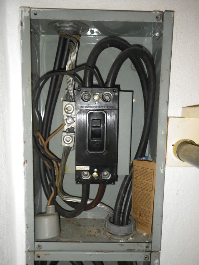

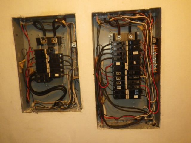

Mark P Posted March 30, 2012 Report Share Posted March 30, 2012 Does anyone know what the NEC said around 1976 about haveing the grounds and neutrals seperated in a sub panel? Were the rules the same as today? Here is what I have the main disconnect is in a bedroom closet at one end of the house and there are two panels in a utility closet in another part of the house. Since they are not anywhere close I consider the distribution panel as sub panels - but there are wired as main panels with all the ground / neutrals on the same bar. Click to Enlarge 74.94 KB Click to Enlarge 42.18 KB Link to comment Share on other sites More sharing options...
fyrmnk Posted March 30, 2012 Report Share Posted March 30, 2012 They should be separated in the sub panels. Also, not sure when it was required, but the disco shouldn't be in a clothes closet either, should it? Link to comment Share on other sites More sharing options...
Jim Katen Posted March 31, 2012 Report Share Posted March 31, 2012 Does anyone know what the NEC said around 1976 about haveing the grounds and neutrals seperated in a sub panel? Were the rules the same as today? Essentially the same, yes. It's wrong now. It was wrong then. It was wrong decades before then. Here is what I have the main disconnect is in a bedroom closet at one end of the house and there are two panels in a utility closet in another part of the house. Since they are not anywhere close I consider the distribution panel as sub panels - but there are wired as main panels with all the ground / neutrals on the same bar. They're wrong. There's not much else to say. Link to comment Share on other sites More sharing options...
edwardh1 Posted April 1, 2012 Report Share Posted April 1, 2012 They should be separated in the sub panels. Also, not sure when it was required, but the disco shouldn't be in a clothes closet either, should it? in south carolina it was frequently placed in master bedroom closets, til it moved to on the stairs to second floor, then moved to the attached garage every 10 years or so it changed Link to comment Share on other sites More sharing options...
