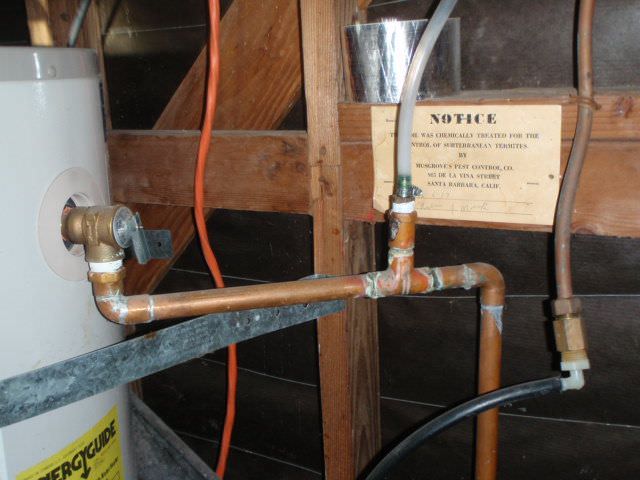

inspectorwill Posted April 18, 2012 Report Share Posted April 18, 2012 Is there any prohibition against plumbing the A/C condensate to a TPR extension? See photo. Click to Enlarge 52.27 KB Quote Link to comment Share on other sites More sharing options...

Jim Katen Posted April 18, 2012 Report Share Posted April 18, 2012 It depends on what code you ask. The IRC says that the TPR relief pipe shall serve a single relief device and shall not connect to piping serving any other relief device or equipment. The UPC doesn't have any similar restricition. Quote Link to comment Share on other sites More sharing options...
