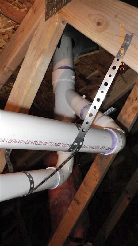

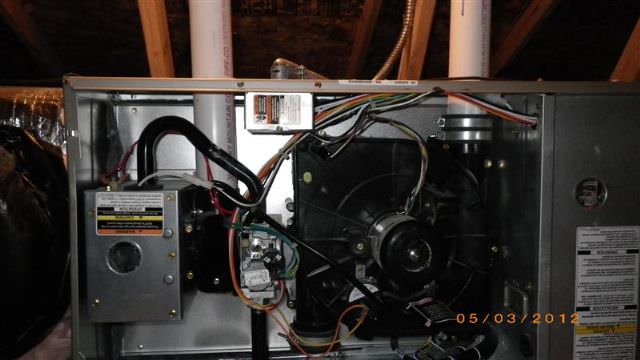

Robert Jones Posted May 4, 2012 Report Share Posted May 4, 2012 New Bryant furnace, model 340AAV. I am not sure why this is bugging me but I have never seen where the air intake and the furnace discharge are routed through the same housing. What am I missing? I couldn't get on the roof of this one. Click to Enlarge 47.74 KB Click to Enlarge 40.57 KB Quote Link to comment Share on other sites More sharing options...

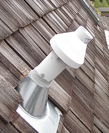

Ken Meyer Posted May 4, 2012 Report Share Posted May 4, 2012 There will be a concentric vent like this one on the roof, but pointing straight up. Click to Enlarge 54.45 KB Quote Link to comment Share on other sites More sharing options...

hausdok Posted May 4, 2012 Report Share Posted May 4, 2012 Like he said. The client won't understand 'concentric' just tell 'em it's a combination intake/exhaust vent terminal and they'll get it first time. Did you get a snap of the condensate drain configuration? ONE TEAM - ONE FIGHT!!! Mike Quote Link to comment Share on other sites More sharing options...
Erby Posted May 4, 2012 Report Share Posted May 4, 2012 Pipe inside a pipe. Quote Link to comment Share on other sites More sharing options...
John Kogel Posted May 5, 2012 Report Share Posted May 5, 2012 Pipe inside a pipe. Thanks, Erby. That beats what I would be spewing. [] Quote Link to comment Share on other sites More sharing options...
