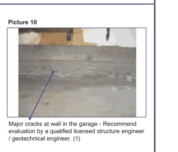

purplepear Posted May 12, 2012 Report Share Posted May 12, 2012 Hi there! I'm new to this forum - just found it on Google - so forgive me for being a noob. I'm in contract to buy a home. We had an inspection done and our inspector recommended we get a separate foundation inspection because a crack in the garage was abnormal. We haven't been able to proceed with the foundation inspection yet because we're waiting on some minor repairs to be done before we throw more money into the house. Needless to say, the listing agent and seller move at a snail's pace and I'm anxious to find out what is going on with the foundation. It's potentially the make or break point for us. I've linked the picture (the only picture we have) from our home inspection of the crack our inspector said was abnormal. Any ideas on how troublesome this could potentially be for us? Click to Enlarge 36.7 KB Quote Link to comment Share on other sites More sharing options...

Marc Posted May 12, 2012 Report Share Posted May 12, 2012 I'm with Jerry. I don't see anything of consequence but then it's only a picture. Seeing it with my eyes, the entire house, might yield a different opinion. Marc Quote Link to comment Share on other sites More sharing options...

Jim Katen Posted May 12, 2012 Report Share Posted May 12, 2012 If your inspector is good, he wouldn't have sent you to an engineer without a good reason. If he's a dope who only cares about covering his own sorry ass, then he might easily spend several hundred of your dollars on a wasted engineering consulation. It's impossible for us to tell you much of anything useful based on your description and on that picture. I can see how it might be totally unimportant, or a really expensive problem, or anything in between. I'd have to see the house to tell. If I were in your position, I'd call the inspector and ask him, "Do you think this could really be a serious problem or is your recommendation just there to cover your sorry ass?" Quote Link to comment Share on other sites More sharing options...

ghentjr Posted May 12, 2012 Report Share Posted May 12, 2012 Any ideas on how troublesome this could potentially be for us? Click to Enlarge 36.7?KB You didn't say how old the house is. The crack looks like a lunchtime pour. (cold seam. where everyone breaks for lunch then continues). A more clear photo would help but if this is an older, (15 or more years home) I would think the crack is a non-issue. You may try calling another inspector in your area, not recommended by a realtor, and pay him/her just to look at the crack without palming it off on someone else. Quote Link to comment Share on other sites More sharing options...
purplepear Posted May 12, 2012 Author Report Share Posted May 12, 2012 The house was built in 1963. So pushing 50 years old. It's possible to pay an inspector to JUST come look at the crack? We've been quoted at $250 (sound about right for the SF Bay Area?) for the foundation inspection so if it's cheaper than that I would certainly consider it an option. Quote Link to comment Share on other sites More sharing options...

Garet Posted May 12, 2012 Report Share Posted May 12, 2012 Asking us to diagnose structural issues from fuzzy internet pictures is like asking your cardiologist to diagnose your heart by holding the phone up to your chest. Sometimes you just have to be there in person to get the whole picture. Is there no text in the report describing what your inspector thinks is going on??? Any engineer worth his weight in salt wouldn't walk out the front door for less than $250. Many inspectors OTOH don't know the true value of their services and charge far less. Beware of cheap opinions - they're usually worth the price paid. Quote Link to comment Share on other sites More sharing options...

purplepear Posted May 12, 2012 Author Report Share Posted May 12, 2012 So I was able to get a few pics that were closer than the one I posted earlier. They're iPhone 4s pics but the quality is still a little better. Quote Link to comment Share on other sites More sharing options...
Jim Katen Posted May 12, 2012 Report Share Posted May 12, 2012 Well, it's not a cold joint. Is this the rear wall of the garage? It almost looks like someone drove into it. Quote Link to comment Share on other sites More sharing options...
gtblum Posted May 12, 2012 Report Share Posted May 12, 2012 I'm starting to get the sense that we totally got a crappy inspector though. How did you find the inspector you hired? Quote Link to comment Share on other sites More sharing options...
purplepear Posted May 12, 2012 Author Report Share Posted May 12, 2012 Yes. It is the rear of the garage wall and the only crack we saw or the inspector saw that was anything like this. I don't know what the likelihood is that someone drove into it? Currently it's flanked by the water heater and the furnace and there's not really room to do that but who knows what was there before? Quote Link to comment Share on other sites More sharing options...

Jerry Simon Posted May 13, 2012 Report Share Posted May 13, 2012 That's not a *normal* crack, so recommend further review[:-angel]. Report didn't give me a stroke. I've got file cabinets full of such from my first few years of inspecting. I think it was harder to kick than cigarettes. . . Quote Link to comment Share on other sites More sharing options...
purplepear Posted May 13, 2012 Author Report Share Posted May 13, 2012 Think the odds are high that it's something serious? I really want this house and if further inspection finds something costly we're going to have to walk. We don't have the funds to invest and seems like the sellers don't or aren't willing to. Quote Link to comment Share on other sites More sharing options...
