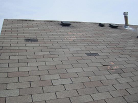

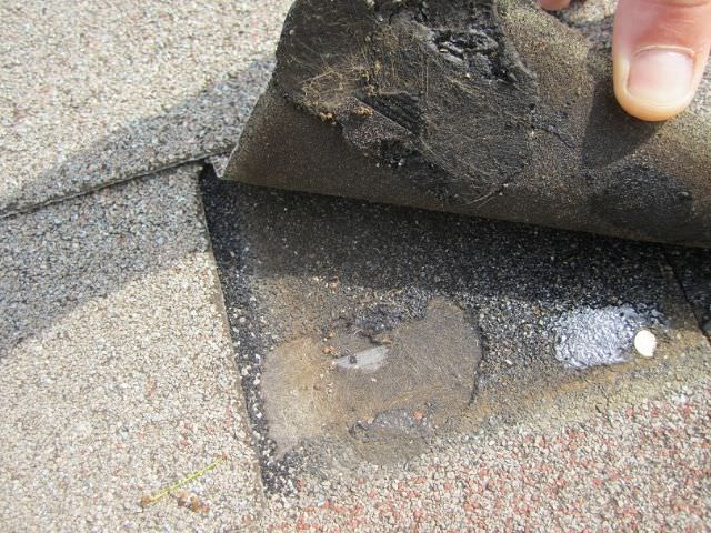

Tom B Posted May 18, 2012 Report Share Posted May 18, 2012 I was called to inspect a roof for hail damage that had been denied by adjuster. When I climbed up on the roof, I noticed dozens of torn through adhesive spots, mostly toward the corners of the tabs. The adjuster says "The rips are indicative of roof sheathing movement due to inadequate ventilation of the roof or improper spacing of the roof sheathing and not related to wind or hail" However, roof is ventilated correctly and there are no leaks on the roof (yet). Nothing notable in the attic. A storm with 60+ MPH wind gusts and hail had moved through the area and damaged most of the homes in the neighborhood. I'm guessing severe delamination and the sealant bonds are just really strong? Click to Enlarge 134.82 KB Click to Enlarge 59.13 KB Click to Enlarge 101.45 KB Click to Enlarge 54.28 KB Quote Link to comment Share on other sites More sharing options...
Tom B Posted May 18, 2012 Author Report Share Posted May 18, 2012 The last photo shows these spots circled and marked "W" Quote Link to comment Share on other sites More sharing options...
hausdok Posted May 18, 2012 Report Share Posted May 18, 2012 It looks like whoever did that roof hand-sealed those shingles against wind lift and tearoff and apparently did a good job. OT - OF!!! M. Quote Link to comment Share on other sites More sharing options...
Marc Posted May 18, 2012 Report Share Posted May 18, 2012 It looks like whoever did that roof hand-sealed those shingles against wind lift and tearoff and apparently did a good job. OT - OF!!! M. Only if the shingle is creased along it's upper exposed edge where the wind would have bent it had it come loose. If there's no accompanying crease of that type then it could be structural movement of the roof deck instead. Marc Quote Link to comment Share on other sites More sharing options...
John Kogel Posted May 18, 2012 Report Share Posted May 18, 2012 The sheathing moves how far? Enough to tear the nails out of a bunch of shingles? There would have to be some serious structural flaws for that scenario. So is the insurance guy saying the shingles stayed stationary while the sheathing dropped? [:-party] The shingles appear to have a weak bond between the layers. The wind may not have folded the shingles back enough to crease them, but tore them loose. Quote Link to comment Share on other sites More sharing options...
Tom B Posted May 18, 2012 Author Report Share Posted May 18, 2012 If the deck moved, wouldn't I see other signs of damage, or even deformation? How much movement would it take to tear a hole out from a shingle? I've never seen anything like this. Also, his back yard is a wide open golf course. The winds came in from that direction, and there are many creased shingles on the roof. Quote Link to comment Share on other sites More sharing options...
hausdok Posted May 18, 2012 Report Share Posted May 18, 2012 Marc, I disagree. The purpose of hand sealing is to prevent the wind folding the shingles back. If the wind was enough to cause the shingles to pull at the adhesive enough to start tearing the shingle below, but not enough to completely pull the shingle loose, fold it back and cause the crease you mention, then the hand sealing did it's job. Sure, the roof is damaged now but it didn't come completely off with the wind and so the homeowner didn't have the kinds of water damage to the attic insulation, ceilings and personal property that he would have had if the whole thing had been peeled off like an onion skin. ONE TEAM - ONE FIGHT!!! Mike Quote Link to comment Share on other sites More sharing options...

Tom B Posted May 19, 2012 Author Report Share Posted May 19, 2012 Thanks for the insight guys. I snipped one of the photos included in the adjusters report of an area with the tearing and tried to make the sheeting position fit the damage. It doesn't even come close to matching up. How would there be tearing in the middle of a sheet if the the decking did move? Click to Enlarge 254.44 KB Quote Link to comment Share on other sites More sharing options...
Marc Posted May 19, 2012 Report Share Posted May 19, 2012 It doesn't even come close to matching up. How would there be tearing in the middle of a sheet if the the decking did move? The adhesive on the shingles makes them, as a whole, less tolerant of movement than the nailed decking. It's sort of like brick veneer on a monolithic concrete foundation. You can gauge how much differential movement has occurred in the foundation by examining cracks, or the lack of them, in the veneer. Portland based mortar is very intolerant of movement. That's something I learned at the University of TIJ. Click to Enlarge 254.44?KB I don't recognize any dominant pattern in the photo. I see no basis for any one particular cause of the tearing, only a basis for a carcophony of causes. Looks like I'm not helping your case. Marc Quote Link to comment Share on other sites More sharing options...
Tom B Posted May 19, 2012 Author Report Share Posted May 19, 2012 Thanks Marc. Your analysis is greatly appreciated. I will have to take a closer look at the home's foundation and look for any other signs of movement. I've been wrong more times than I would like to admit identifying causes of damage to roofs, but I've learned something new every time. In this case, I assumed wind, because it seemed like the most likely explanation considering the abundance of supporting evidence. Quote Link to comment Share on other sites More sharing options...

Jim Katen Posted May 20, 2012 Report Share Posted May 20, 2012 Clearly the shingles were hand sealed. I suspect that the hand sealing simply glued the shingles together too well, to the point where there's little ability for them to expand and contract with normal heating and cooling cycles. Over time, they tear at the corners, often in a stairstep pattern. Nothing in any of the pictures looks even remotely like wind damage. Quote Link to comment Share on other sites More sharing options...

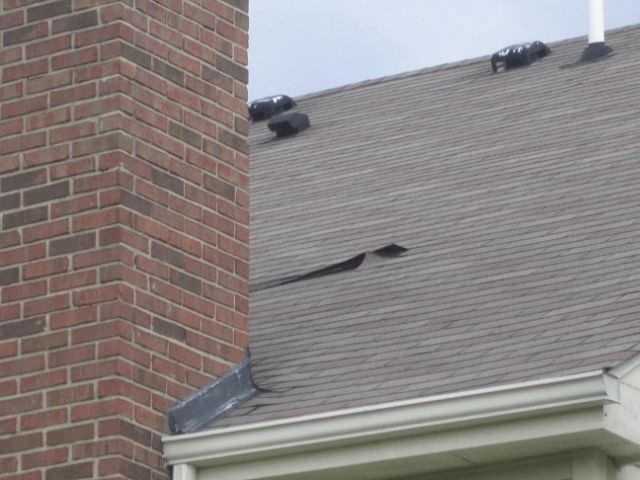

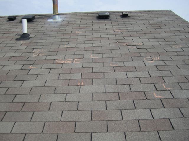

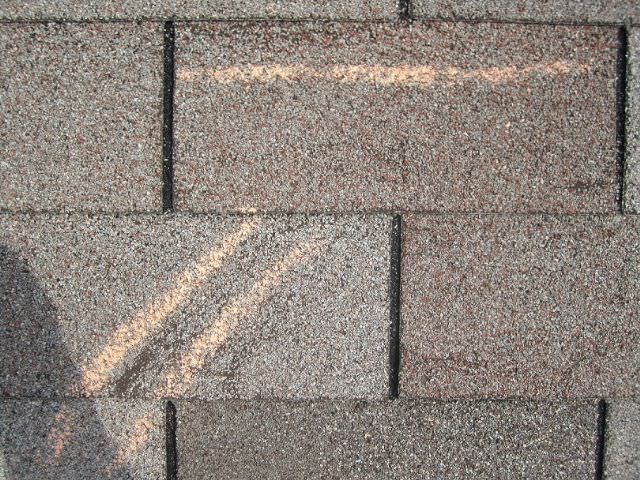

Tom B Posted May 20, 2012 Author Report Share Posted May 20, 2012 Here are some photos of other areas of the same slope. These rips are everywhere on the south slope. I didn't find any on the north facing slope. I also counted over 30 creased tabs on the south slope, but now I'm beginning to wonder if they are wind related at all. Click to Enlarge 31.94 KB Click to Enlarge 130.61 KB Click to Enlarge 50.27 KB Quote Link to comment Share on other sites More sharing options...
Marc Posted May 20, 2012 Report Share Posted May 20, 2012 Wind damage. Not much though. Marc Quote Link to comment Share on other sites More sharing options...
Jim Katen Posted May 20, 2012 Report Share Posted May 20, 2012 Here are some photos of other areas of the same slope. These rips are everywhere on the south slope. I didn't find any on the north facing slope. I also counted over 30 creased tabs on the south slope, but now I'm beginning to wonder if they are wind related at all. Click to Enlarge 31.94?KB Click to Enlarge 130.61?KB Click to Enlarge 50.27?KB Now, *those* pictures show wind damage. And from the looks of it, the damaged tabs weren't hand sealed. Also, the fact that the "rips" are on the south side bolsters my opinion that you've got thermal tearing on that side. Quote Link to comment Share on other sites More sharing options...
