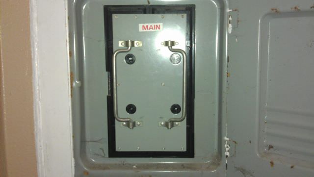

Robert Jones Posted July 20, 2012 Report Share Posted July 20, 2012 Pic was sent to me so I have no background info. Looks like a disconnect of some sort, just have not seen one like this in a residential home. I was told that there is an actual panel below this. Was told the three black circles are plastic. Is it a main pull out disconnect or...? Thanks. Click to Enlarge 23.65 KB Quote Link to comment Share on other sites More sharing options...
kurt Posted July 20, 2012 Report Share Posted July 20, 2012 Looks like a pullout knife switch, or maybe a cartridge. Most likely the main disconnect. Quote Link to comment Share on other sites More sharing options...
Jerry Simon Posted July 20, 2012 Report Share Posted July 20, 2012 Main cartridge disco Quote Link to comment Share on other sites More sharing options...
Jim Katen Posted July 20, 2012 Report Share Posted July 20, 2012 Yes, it's a big fuse block. Quote Link to comment Share on other sites More sharing options...
Rob Amaral Posted July 20, 2012 Report Share Posted July 20, 2012 Main disconnect ... that is not an abnormal thing to see in the East.. Quote Link to comment Share on other sites More sharing options...
