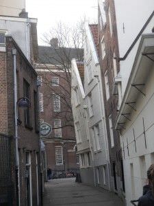

Bill Kibbel Posted July 31, 2012 Report Share Posted July 31, 2012 Drought or ground water removal is a fairly common cause of subsidence under old buildings. About 25 years ago, I toured several historic buildings in New Orleans that were severely leaning. Some had sloped floors at about 2/12. The owners/occupants weren't the least bit bothered by it. The owner of a 1-story bar with a 4 story building leaning over it was a bit concerned. Amsterdam has many sinking, twisted and leaning old buildings. Much of the city was built on marshes that were drained. Click to Enlarge 17.16 KB Link to comment Share on other sites More sharing options...
Marc Posted August 1, 2012 Report Share Posted August 1, 2012 Drought or ground water removal is a fairly common cause of subsidence under old buildings. About 25 years ago, I toured several historic buildings in New Orleans that were severely leaning. Some had sloped floors at about 2/12. The owners/occupants weren't the least bit bothered by it. The owner of a 1-story bar with a 4 story building leaning over it was a bit concerned. Amsterdam has many sinking, twisted and leaning old buildings. Much of the city was built on marshes that were drained. Click to Enlarge 17.16?KB And aggravated by clay deposits. NOLA is famous for that. Marc Link to comment Share on other sites More sharing options...
