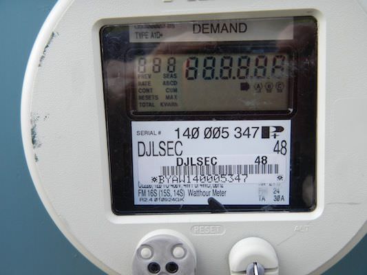

kurt Posted August 21, 2012 Report Share Posted August 21, 2012 How would I describe this? First, it's a mess. Arch flashed bus tabs, loose breakers, masthead falling off building, etc. I'm not sure of voltage and amperage. Not sure how to read the meter. 3/0 copper supplying a 3 phase load center. Click to Enlarge 31.93?KB Click to Enlarge 58.4?KB Quote Link to comment Share on other sites More sharing options...

kurt Posted August 21, 2012 Author Report Share Posted August 21, 2012 I got that part; I just want to describe it accurately. What's the amperage and voltage? Quote Link to comment Share on other sites More sharing options...
Tom Raymond Posted August 21, 2012 Report Share Posted August 21, 2012 The amperage is determined the same way regardless of how many phases there are. You didn't measure the voltage? Tsk, tsk. Call the Utility. Quote Link to comment Share on other sites More sharing options...
Marc Posted August 21, 2012 Report Share Posted August 21, 2012 Tom's right. You gotta measure the voltage. It's probably either 120/240 three phase or 120/208 three phase. 120/208 is common for apartments and condos. 120/240 is more common for industrial where there's some 120/240 single phase loads but mostly heavy 3 phase loads like motors,heaters, etc. The meter won't tell you. Use the main breaker size for amperage unless it's more than the ampacity of the service conductors. The ampacity of the service conductors can be found in Table 310.15. You need both the size (3/0) and the type (THHN, THHW, etc). Marc Quote Link to comment Share on other sites More sharing options...
John Kogel Posted August 21, 2012 Report Share Posted August 21, 2012 How do you two propose he measure the voltage? Between any two legs it is 208 volts. Between any leg and neutral it is 120 volts. Each leg can safely carry 100 amps. Now describe that, and that is what you got. Quote Link to comment Share on other sites More sharing options...
Marc Posted August 21, 2012 Report Share Posted August 21, 2012 How do you two propose he measure the voltage? Between any two legs it is 208 volts. Between any leg and neutral it is 120 volts. Each leg can safely carry 100 amps. Now describe that, and that is what you got. With a voltage meter at the top of the main breaker or did I misunderstand the question? A 120/240 configuration has 240 v between any two lines. One secondary winding is center-tapped to make a neutral. So, this configuration has two lines that measure 120V to neutral and the 3rd line is 208V to neutral. Like I said, this configuration isn't common in apartments and condos. I don't know what type of facility Kurt is referring to. Marc Quote Link to comment Share on other sites More sharing options...
kurt Posted August 21, 2012 Author Report Share Posted August 21, 2012 Small industrial. No rating sticker on the main breaker or panel. 3/0 copper, THW. It's probably 240 volts; it doesn't really matter in any meaningful way. I' just wanted to describe it correctly. Quote Link to comment Share on other sites More sharing options...
Marc Posted August 21, 2012 Report Share Posted August 21, 2012 200 amp. Marc Quote Link to comment Share on other sites More sharing options...
kurt Posted August 22, 2012 Author Report Share Posted August 22, 2012 That's what I figured. Thanks for the confirm. Lacking any pointers or rating plates, I didn't know if the meter had something to do with it. Quote Link to comment Share on other sites More sharing options...
Jim Katen Posted September 29, 2012 Report Share Posted September 29, 2012 That's what I figured. Thanks for the confirm. Lacking any pointers or rating plates, I didn't know if the meter had something to do with it. Just as a point of interest, the sticker that's been placed over the meter obscures the "CL200" at the lower left side. You could also tell that it's a 200-amp meter by the "TA30" designation, which indicates that the meter was calibrated at 30 amps (Test Amps), which is the calibration level for a 200-amp meter. Quote Link to comment Share on other sites More sharing options...
