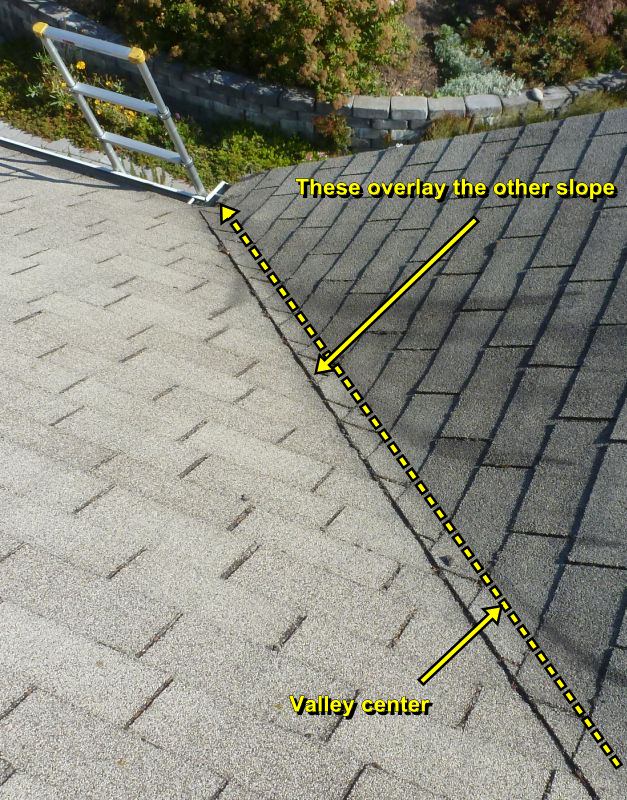

Richard Moore Posted October 7, 2012 Report Share Posted October 7, 2012 So, as soon as I get on the ladder my first thought was "that doesn't look right". Small older house with two closed cut valleys at a "decorative" gable. The shingles have been cut with the overlay edge on the up slope. It seems wrong, and I can't remember seeing one done like this before, but is it really a big deal?. It's an older roof with probably not much more than another 5 years left, but otherwise is in OK condition. There were zero indications of leaks in the attic or interior near these valleys. While it seems and looks ass-backwards, isn't it effectively just a little extra overlay? In other words, does it really matter if some runoff seeped under the "glued" edge if it would still have to go a long way uphill, between layers, on the other side of the valley to cause problems? Download Attachment: 121006W033x.jpg 290.89 KB Quote Link to comment Share on other sites More sharing options...

Marc Posted October 7, 2012 Report Share Posted October 7, 2012 Big deal only if a leak is observed or if other issues combine to put the covering closer to the end of it's life than typical. Marc Quote Link to comment Share on other sites More sharing options...
Chad Fabry Posted October 7, 2012 Report Share Posted October 7, 2012 Once the water is below the top layer, it's free to migrate along the tops of the shingles horizontally. There's a reason manufacturers specify the two inch to the high side cut line. Quote Link to comment Share on other sites More sharing options...
