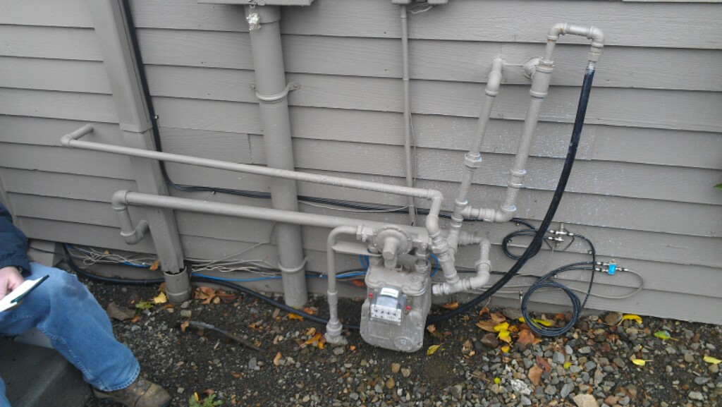

Brandon Whitmore Posted November 30, 2012 Report Share Posted November 30, 2012 I was called out to figure out a gas odor in a garage today. I found & fixed 4 small leaks in the garage, but don't believe that what the customer smelled was from them, because there wasn't any history of recent pipe work. After fixing the leaks, I walked out and found this: Click to Enlarge 825.69 KB This meter and 3/4'' house line is rated at about 200,000 btu's, while there was a load of over 500k btu's in the home. I'm pretty sure the issue was from pressure drop/ delayed ignition when all equpment kicked on, but didn't confirm before changing out the meter. Just something else to watch out for-- extremely undersized meters, which is common. Quote Link to comment Share on other sites More sharing options...

Brandon Whitmore Posted December 1, 2012 Author Report Share Posted December 1, 2012 At what point do you decide that it's better to just switch to a 2 psi system? I don't think that the guys who piped this meter are smart enough to do a 2# set ......... We have no set standard for when 2# is required, although if a generator is installed on the property, they typically have to, due to the appliance reg. pressure requirements. We try to stick with a max. 630 meter on residential sets, so if someone has a load of 6+ therms, they'll be pushed to go to a 2# set. Ideally, contractors just make the smart choice to go with 2# sets so they can save some money. I don't think that much of the piping in this example would have come close to passing the 60# pressure test required for 2#. That, and the meter on this one would still be undersized for 2#. I recommend a 2# set when I find undersized houseline. For example, when someone switches over to a tankless water heater, or when loads are added. Quote Link to comment Share on other sites More sharing options...
