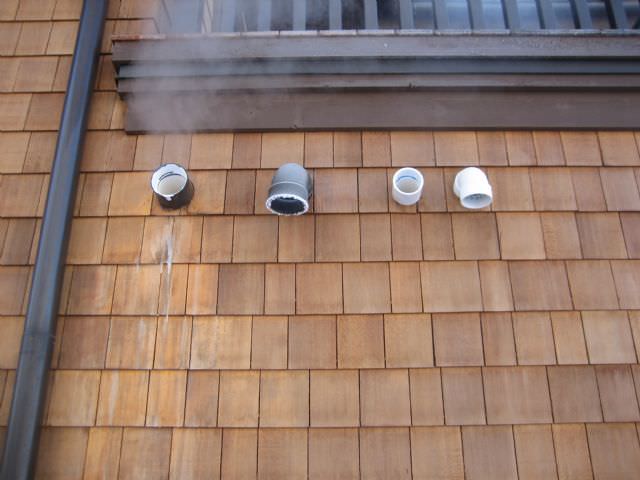

4000sposse Posted February 27, 2013 Report Share Posted February 27, 2013 Am i missing something, or should all exhaust flues and intakes for furnaces, or boilers have bird screens? The last few inspections I have done have had missing screens... in all cases there will be a screen on one or two of the pipes but not all. Click to Enlarge 45.77 KB Quote Link to comment Share on other sites More sharing options...

Tom Raymond Posted February 27, 2013 Report Share Posted February 27, 2013 What's staining the cedar under the left vent, condensate or bird shit? If it's the latter you need a screen. Quote Link to comment Share on other sites More sharing options...
Mike Lamb Posted February 27, 2013 Report Share Posted February 27, 2013 If you have the appliance model # you could probably look it up. Some Rheems say no screens, and I have read others that it is OK with certain grate size restrictions. . Quote Link to comment Share on other sites More sharing options...
John Kogel Posted February 27, 2013 Report Share Posted February 27, 2013 What's staining the cedar under the left vent, condensate or bird shit? If it's the latter you need a screen. Take a good look at that vent on the left and you will see vapor coming out of it. Birds won't go there, although they might if that appliance is shut off for long periods of time. Quote Link to comment Share on other sites More sharing options...

4000sposse Posted February 28, 2013 Author Report Share Posted February 28, 2013 The "staining" under the left is frozen condensation coming from the boiler exhaust. Very cold today but during the summer one will rarely run and the other will not run at all. I am going to recommend screens on all. I will check the manufacturer info. What is strange is that why did the guy put a screen on one but not the others? This is the forth time I have seen this, this year. Doesn't matter I think they should be there. Thanks all. Quote Link to comment Share on other sites More sharing options...
Bill Kibbel Posted February 28, 2013 Report Share Posted February 28, 2013 Am i missing something, or should all exhaust flues and intakes for furnaces, or boilers have bird screens? No. Some manufacturers specifically prohibit it. Doesn't matter I think they should be there. If you recommend screens, it better be specifically permitted by the manufacturer of the equipment. If permitted, the screen better meet the specifics listed in the instructions. I know one that require "a properly engineered louver". Quote Link to comment Share on other sites More sharing options...

emalernee Posted March 1, 2013 Report Share Posted March 1, 2013 I installed the stainless steel screen that the manufacture provided but it iced up over the first winter and kept shutting my furnace off. I removed it and now when I do my yearly cleaning of the unit, I open up the sealed combustion chamber and remove the BBQ'd bird of squirrel. If an animal gets in there during the summer, the smell tells me I need to do a cleaning. Quote Link to comment Share on other sites More sharing options...
4000sposse Posted March 7, 2013 Author Report Share Posted March 7, 2013 Am i missing something, or should all exhaust flues and intakes for furnaces, or boilers have bird screens? No. Some manufacturers specifically prohibit it. Doesn't matter I think they should be there. If you recommend screens, it better be specifically permitted by the manufacturer of the equipment. If permitted, the screen better meet the specifics listed in the instructions. I know one that require "a properly engineered louver". You are right. I contacted the manufacturer both by phone message and email, left serial number of units and asked "if it was ok to put on screens." Never got a reply, so I stated in the report to check equipment manual if screens are OK and check any specifications or requirements. That should cover it, thanks for the replies all. Quote Link to comment Share on other sites More sharing options...
