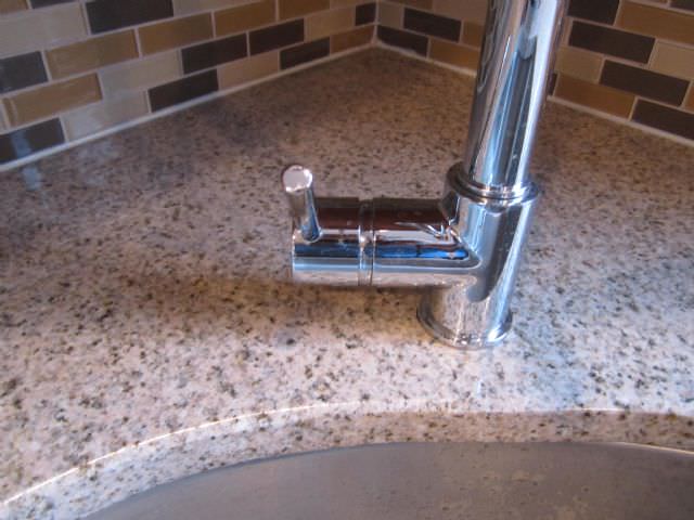

allseason Posted March 16, 2013 Report Share Posted March 16, 2013 On a kitchen faucet-the type with the valve handle that pulls out to the side to turn on the water and then moves from front to back to control temperature. Should the hot increase as you push the handle rearward, that's what I commonly see. I had one today where the water temperature rose when the handle was pulled forward. This one looks to be installed backwards as the handle is commonly on the right. Click to Enlarge 56.12 KB Quote Link to comment Share on other sites More sharing options...
Mike Lamb Posted March 16, 2013 Report Share Posted March 16, 2013 I don't know but I would never mention it at a kitchen faucet unless there was some obvious inconvenience. Quote Link to comment Share on other sites More sharing options...
Nolan Kienitz Posted March 16, 2013 Report Share Posted March 16, 2013 If the valve were rotated to be on the right side of the faucet then pushing it back would be hot. What I would perceive as "expected". This one is still doing the same thing, but has been rotate to the 'left' side of the faucet. Quote Link to comment Share on other sites More sharing options...
Erby Posted March 16, 2013 Report Share Posted March 16, 2013 Someone had it done especially that way because they're left handed. Quote Link to comment Share on other sites More sharing options...
allseason Posted March 16, 2013 Author Report Share Posted March 16, 2013 Someone had it done especially that way because they're left handed. House is a flipper, left handed plumber maybe. I think conventional is hot to the back. Quote Link to comment Share on other sites More sharing options...
John Kogel Posted March 16, 2013 Report Share Posted March 16, 2013 Left-handed faucet, I'm afraid it is wrong, even tho I was born left-handed.[:-thumbd] It is a quick fix for someone that is 'handy'. See, I made a joke. Some models have a red and a blue dot. It seems to me red is on the left, blue on the right, so the handles goes forward for hot. Those I would mention if the red dot side runs cold. Same thing tho, easy fix. Quote Link to comment Share on other sites More sharing options...
allseason Posted March 16, 2013 Author Report Share Posted March 16, 2013 It has the word HOT to give direction and that much is correct as it is at the front, but it is so small that it's insignificant. Quote Link to comment Share on other sites More sharing options...

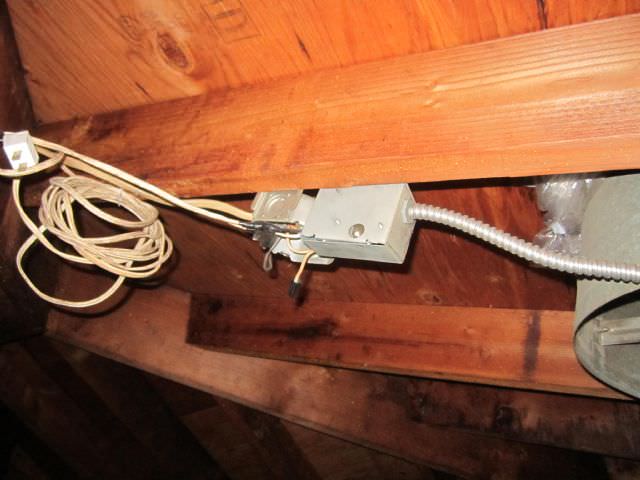

kurt Posted March 16, 2013 Report Share Posted March 16, 2013 What that faucet is really telling you is there's more stupid stuff elsewhere. Quote Link to comment Share on other sites More sharing options...
allseason Posted March 16, 2013 Author Report Share Posted March 16, 2013 Such as the power vent in the attic wired with a lamp cord? Hollow core wood door between the garage and boiler area in the basement? The hardwood floors sanded with a 60 grit and finished with half a coat of poly? It's all good though as the realtor informs me they've gotten the C of O. Click to Enlarge 49.61 KB Quote Link to comment Share on other sites More sharing options...
