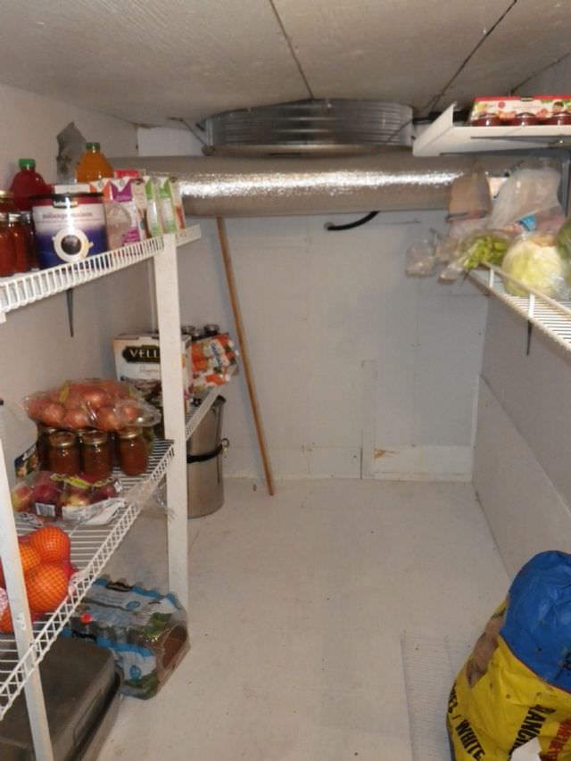

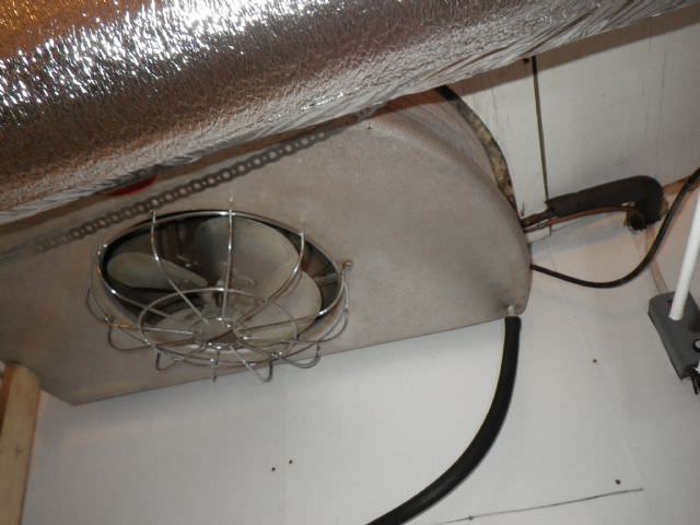

Stephen Lagueux Posted March 21, 2013 Report Share Posted March 21, 2013 From today's inspection. Not quite air tight but clever nonetheless. Click to Enlarge 63.85 KB Click to Enlarge 43.12 KB Click to Enlarge 58.41 KB Quote Link to comment Share on other sites More sharing options...
Tom Raymond Posted March 21, 2013 Report Share Posted March 21, 2013 Built one for a church kitchen out of aluminum sunroom components. They paid for a real chiller. Quote Link to comment Share on other sites More sharing options...
John Kogel Posted March 23, 2013 Report Share Posted March 23, 2013 They might have had a home business like catering or similar. I would call for the wiring resting on the line from the compressor to be in conduit and supported properly. Vibration will rub a hole in the insulation there. I knew a couple that built a larger cooler like that for their fresh flower business. There's too much air to keep cold in a setup like that. Like running an almost empty chest freezer. Quote Link to comment Share on other sites More sharing options...
