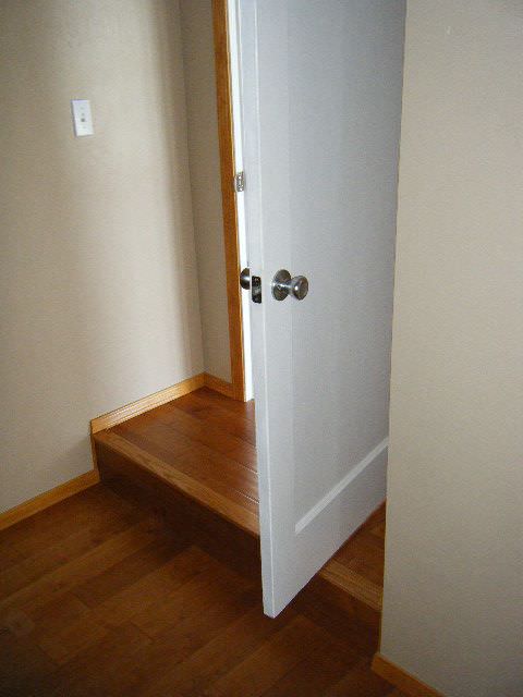

Denray Posted April 13, 2013 Author Report Share Posted April 13, 2013 Well done main and sub panel on a flipper, but no AFCI's. Seemed weird to go that far without doing it all. But you can't grandfather in a new panel without AFCI's. GFCI's were in place at the outlet locations. They put laminate over the old garage slab floor that was made into a bedroom which seems like asking for trouble. A door swings over the step down into this area. Plumbing below had very poor support. Made the carport into a garage with a window and door with glass to main house on one side. Grout down on top of tub. Etc. Must be no permit or no final? Click to Enlarge 61.12 KB Click to Enlarge 95.33 KB Click to Enlarge 37.4 KB Quote Link to comment Share on other sites More sharing options...
