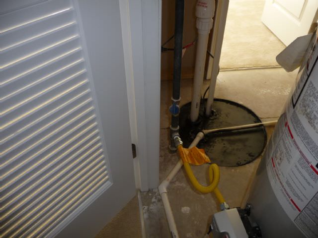

John Dirks Jr Posted May 14, 2013 Report Share Posted May 14, 2013 The black iron pipe comes down from the ceiling. It is supported at the ceiling and drops down 7' before connecting the the appliance connector. There is no support for the piping at the bottom and it moves around easily. Is there any supporting documentation or code language that says this installation is not correct? I've been looking for a while but haven't quite nailed it. Shouldn't there be support at the pipe end? Click to Enlarge 44.46 KB Quote Link to comment Share on other sites More sharing options...
Brandon Whitmore Posted May 14, 2013 Report Share Posted May 14, 2013 We have it here: g2418 Cross reference that to whatever IRC you are working from..... Quote Link to comment Share on other sites More sharing options...
John Dirks Jr Posted May 14, 2013 Author Report Share Posted May 14, 2013 Thanks Brandon. There's also this, if its 1 1/4" pipe or larger. http://publicecodes.cyberregs.com/icod/ ... par386.htm Quote Link to comment Share on other sites More sharing options...
