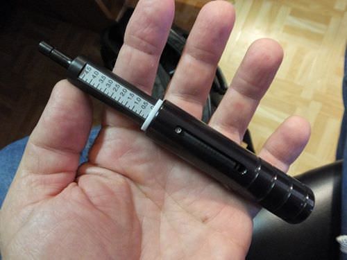

Marc Posted November 29, 2013 Report Share Posted November 29, 2013 I've gotten a few of those on a particular antebellum-style home near me. I do electrical work for them. I advise that the load first be shifted to temporary supports then dig the area down to soil having 2,500 Lbs/SF capacity then build up a pier from there. After that's done, backfill the hole. I have a pocket penetrometer I use for this sometimes. The scale is tons/SF. You press it down into the soil until the ring on the tip is flush with the surface of the soil. Click to Enlarge 28.64 KB Marc Quote Link to comment Share on other sites More sharing options...

John Kogel Posted November 29, 2013 Author Report Share Posted November 29, 2013 Adding other columns and piers to help take the load off the one might be easiest. I agree, but this particular beam has a butt splice right there. So I guess they would need two posts, a long and a short. That's a nifty tool, Marc. Good for checking the mud down at the levee. [] Quote Link to comment Share on other sites More sharing options...
