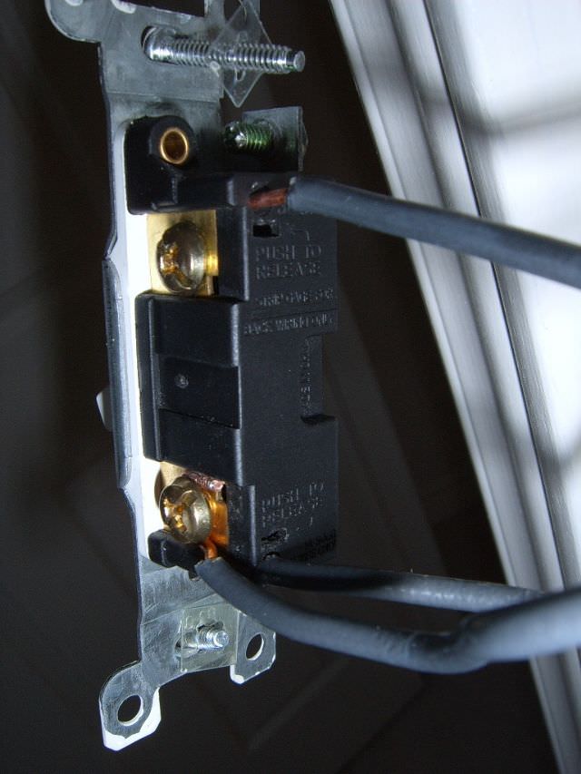

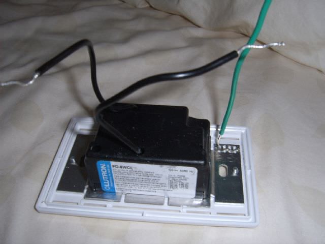

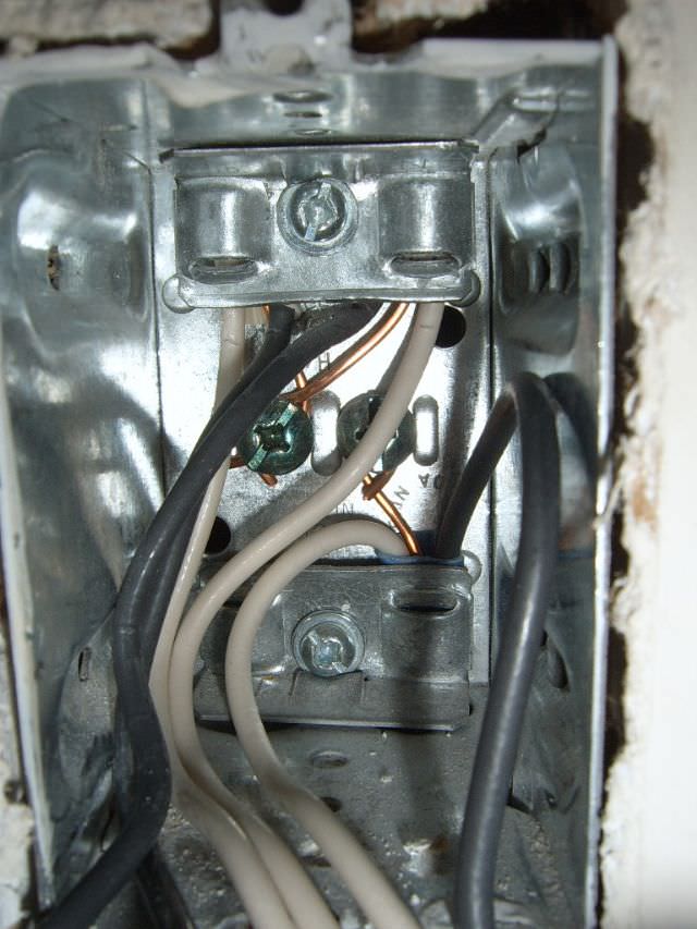

tb426 Posted March 30, 2014 Report Share Posted March 30, 2014 Hello all members, New to this forum. I would like know how to change a traditional ON/OFF switch to a dimmer light switch. The light switch is NOT a 3-way, and is the only switch in the bedroom that can turn the light on/off. Here are the details with pics: 1) There are three white wires, and are all connected to one single marrettes (Picture 1) 2) There are also 3 black wires, two on top (left corner and right corner), and one at the lower right corner 3) there are two green screw on the inside of the box Click to Enlarge 93.84 KB 3) Of the three black wires, the top left corner one is twisted like a hook and screwed into the old light switch on the side. It is NOT screwed to the green screw. The other two wires go directly into the switch (Picture 2) Click to Enlarge 68.87 KB 4) The new dimmer is Lutron brand, and has two black wires and one green wire. From what I read, the green is the ground, but there is no ground wires (or a wire currently screwed to the green screw) in the old switch. (Picture 3) Click to Enlarge 34.53 KB Can some experts maybe shed some lights as to how can I wire this myself? Thanks! Quote Link to comment Share on other sites More sharing options...
mjr6550 Posted March 30, 2014 Report Share Posted March 30, 2014 You should have instructions with the dimmer switch. The two black wires are connected the same way as with the standard switch. the green wire should be connected to a screw in the metal box where the bare wire is connected. However, before installing the dimmer switch I suggest that you do some reading on basic electrical wiring. From the questions you are asking it is clear that you do not have any experience in this area. Asking for help is fine, but you should get some additional knowledge so that you understand what you are doing. Quote Link to comment Share on other sites More sharing options...
Marc Posted March 30, 2014 Report Share Posted March 30, 2014 The two black wires at the bottom of photo #2 are the 'hot' wires and should be joined together with either of the black wires on the dimmer. The wire at the top in photo #2 is the switch leg which connects to the light fixture. That one connects to the other black wire on the dimmer. The green wire on the dimmer connects to the two un-insulated wires at the back of the box which should all be connected together before a third un-insulated wire connects them to the box. That makes for 4 uninsulated or green wires coming together in a wire nut. This assumes that only one light fixture is connected to the switch. Marc Quote Link to comment Share on other sites More sharing options...
Erby Posted March 31, 2014 Report Share Posted March 31, 2014 Look close at the first picture. There are three - three wire cables coming into the box. Each has a white, black and uninsulated ground wire. One comes in bottom right One comes in top right One comes in top left. Quote Link to comment Share on other sites More sharing options...

tb426 Posted March 31, 2014 Author Report Share Posted March 31, 2014 Thanks for all the inputs. I followed Marc's suggestion and just changed the dimmer and it works perfectly so far! Quote Link to comment Share on other sites More sharing options...
David Meiland Posted March 31, 2014 Report Share Posted March 31, 2014 Whoever did the wiring in the photos did a few odd things, or at least things I wouldn't expect to see here. The ground wires are cut too short, and each is connected individually to the screws in the back of the box. The screw on the left appears to have two wires wrapped part way around it, one in each direction. I would expect to see two of the wires about 6" long, and the third about 12" long. There would be a green wire nut connecting all three grounds together, with the 12" wire coming out the end of the nut and going to the screw (where it would be wrapped all the way around). I don't think I've ever seen a metal box with two ground screws in it. The third romex in the box is likely a feeder to another switch somewhere (Marc called them both "hot"), but I wouldn't expect to see it connected to the switch. It would be pigtailed with the hot and a 6" wire that went to the switch. Maybe the guy who did it didn't have any wire nuts. Or, is this typical elsewhere? Quote Link to comment Share on other sites More sharing options...
Tom Raymond Posted April 1, 2014 Report Share Posted April 1, 2014 Not here. The guy that wired the first switch likely only knows slightly more than our OP. Quote Link to comment Share on other sites More sharing options...
Jim Port Posted April 1, 2014 Report Share Posted April 1, 2014 There was power in, power out on one side of the switch with the device making the splice instead of a wire nut. The other connection was the switched hot. Nothing at all unusual, but many would consider it less than optimal practice to use the backstab as a splice. Quote Link to comment Share on other sites More sharing options...

rkenney Posted April 2, 2014 Report Share Posted April 2, 2014 Looks to me like this guy already has an overfilled box. Stickin' a dimmer into it won't help. Correct my math if necessary: 14 gauge wire - 6 conductors, 1 ground, 1 clamps, 2 device= 10 x 2.0 = 20 cubic inches. The box he shows is 2x3 the deepest of which is 18 cubic inches at 3.5 inches deep. Quote Link to comment Share on other sites More sharing options...
Jim Port Posted April 2, 2014 Report Share Posted April 2, 2014 The CEC might have different box fill rules. Quote Link to comment Share on other sites More sharing options...
