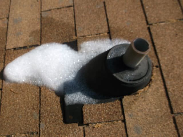

Charles46 Posted May 12, 2014 Report Share Posted May 12, 2014 Gentlemen: This foam had come out of the boot flange or appeared to come out of the boot flange of the laundry room vent stack. The pipe did not feel wet as would have been my expectation. Any idea how or why the bubbles? Thanks. Click to Enlarge 43.27 KB Quote Link to comment Share on other sites More sharing options...
Robert Jones Posted May 12, 2014 Report Share Posted May 12, 2014 Looks like soap. Quote Link to comment Share on other sites More sharing options...
Bill Kibbel Posted May 12, 2014 Report Share Posted May 12, 2014 It probably bubbled up from the inside the vent pipe - then evaporated quicker on the warm pipe. If it bubbled up from below the vent collar, it would be an obvious wet mess inside just below. Quote Link to comment Share on other sites More sharing options...
Charles46 Posted May 13, 2014 Author Report Share Posted May 13, 2014 Everything inside was found to be normal, well as normal as could be. I just never had the pleasure of seeing soap bubble all the way up the vent like that prior to today. See something new everyday. Thanks for the feedback. Quote Link to comment Share on other sites More sharing options...
John Kogel Posted May 13, 2014 Report Share Posted May 13, 2014 Something is seriously wrong with the drainage for the vent to be blowing bubbles like that. The washer is pumping soapy water into the drainstack faster than it can get away, IMO. Quote Link to comment Share on other sites More sharing options...
mjr6550 Posted May 13, 2014 Report Share Posted May 13, 2014 I second John's answer. Quote Link to comment Share on other sites More sharing options...
Tom Raymond Posted May 13, 2014 Report Share Posted May 13, 2014 Did someone put dish soap in the washer? That would make lots of bubbles. Quote Link to comment Share on other sites More sharing options...
David Meiland Posted May 13, 2014 Report Share Posted May 13, 2014 Any chance those folks are new owners of a high efficiency washer? It's easy to put in way too much soap if you're not used to it. Quote Link to comment Share on other sites More sharing options...
Rob Amaral Posted May 13, 2014 Report Share Posted May 13, 2014 The drain below that vent can't keep up.. perhaps an obstruction.. ? Or Moe, Larry and Curly were just working on the house??? Quote Link to comment Share on other sites More sharing options...
Charles46 Posted May 13, 2014 Author Report Share Posted May 13, 2014 It is a new high efficiency washer on an old home with a 1 1/2" drain pipe. Quote Link to comment Share on other sites More sharing options...
Jim Baird Posted May 13, 2014 Report Share Posted May 13, 2014 I was told once that the code change a few yrs back requiring clothes washer standpipe to join directly to a minimum three-inch branch was due to soapmakers' efforts over time to make their product more and more sudsy, because market research told them the sudsier the better in consumer's mind. If the home is older and the 1 1/2 connects with a 2 the suds may be backing up the vent. Quote Link to comment Share on other sites More sharing options...
kurt Posted May 13, 2014 Report Share Posted May 13, 2014 That's right. Conventional soap on a 1 1/2" pipe will back up from foam overload. Quote Link to comment Share on other sites More sharing options...
