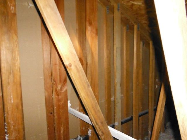

Denray Posted June 17, 2014 Report Share Posted June 17, 2014 In a duplex shouldn't this wall have drywall on this side too for fire protection? Click to Enlarge 44.14 KB Quote Link to comment Share on other sites More sharing options...
patt Posted June 17, 2014 Report Share Posted June 17, 2014 Depends Check CRC R302.3 - ex2 (same for both 2010 and 2013) May only need drafting stopping. If you don't have the current code, 2013, you can view it here. http://www.ecodes.biz/ecodes_support/Fr ... _main.html Quote Link to comment Share on other sites More sharing options...
