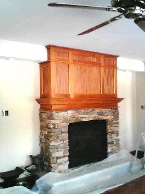

gtblum Posted April 27, 2015 Author Report Share Posted April 27, 2015 I still think handling a large highly figured panel through an old raised panel shaper blade was one of the woodworking's most daunting tasks. Yes, Sir! Not too many things more exciting than having a whirling chunk of carbide and steel as big as your fist, at belly height, with no Kevlar vest. The sound alone, backed my friend up a few steps. One slip and the panel is junk. Rotate the piece the wrong way, you get tear out. Try to take the whole cut in one pass, you're an idiot asking for it. [] Mantle in the same house from a few years back. The boat never stood a chance of being finished. Click to Enlarge 47.52 KB Quote Link to comment Share on other sites More sharing options...
Marc Posted April 27, 2015 Report Share Posted April 27, 2015 Mantle in the same house from a few years back. The boat never stood a chance of being finished. Click to Enlarge 47.52 KB Nice looking woodwork, but above a fireplace?? A place where folks deliberately build fires? Marc Quote Link to comment Share on other sites More sharing options...
gtblum Posted April 28, 2015 Author Report Share Posted April 28, 2015 Nice looking woodwork, but above a fireplace?? A place where folks deliberately build fires? Marc I think it's a fad that started about 2000 years ago. Eventually, it will burn out. Seriously, to begin with, this is a gas unit. Either way, if you have an open fire that is big enough to threaten a wood mantle, you're already in a world of trouble. Quote Link to comment Share on other sites More sharing options...
