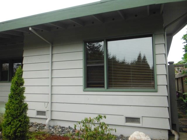

Denray Posted May 29, 2015 Report Share Posted May 29, 2015 Strange plugs in the siding for what? Click to Enlarge 31.97 KB Quote Link to comment Share on other sites More sharing options...
Jerry Simon Posted May 29, 2015 Report Share Posted May 29, 2015 I think the arrows are strange. Plugs to cover holes when wall insulation was added would be my guess. Quote Link to comment Share on other sites More sharing options...
Erby Posted May 29, 2015 Report Share Posted May 29, 2015 I agree with Jerry. Common in the 50's and 60's, maybe even into the 70's. Quote Link to comment Share on other sites More sharing options...
kurt Posted May 29, 2015 Report Share Posted May 29, 2015 It started in the 70's. I'm not aware of anyone doing insulation retrofits in the 50's and 60's. But, for sure insulation retrofit. Pull a plug to see if it's UFFI. Not that UFFI is bad, but the general public perception, driven by idiotic government mandates since repealed, has made it "bad". You want to know if it's UFFI. Quote Link to comment Share on other sites More sharing options...
Denray Posted May 29, 2015 Author Report Share Posted May 29, 2015 I wonder why just that wall? Quote Link to comment Share on other sites More sharing options...
kurt Posted May 29, 2015 Report Share Posted May 29, 2015 It was the cold one...(?).. Quote Link to comment Share on other sites More sharing options...
Denray Posted May 29, 2015 Author Report Share Posted May 29, 2015 North bedroom wall, east side. Click to Enlarge 47.16 KB Quote Link to comment Share on other sites More sharing options...
