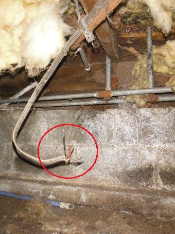

Denray Posted August 10, 2015 Report Share Posted August 10, 2015 That black wire, which was hot, was even closer to the supply pipe before I moved it. Click to Enlarge 51.24 KB Link to comment Share on other sites More sharing options...
Jim Katen Posted August 11, 2015 Report Share Posted August 11, 2015 What happened when you touched it to the pipe? Link to comment Share on other sites More sharing options...
Chad Fabry Posted August 11, 2015 Report Share Posted August 11, 2015 What happened when you touched it to the pipe? Either a big ass spark or a loud scream from the first floor bathroom. Link to comment Share on other sites More sharing options...

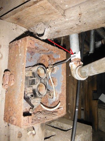

Denray Posted August 11, 2015 Author Report Share Posted August 11, 2015 You guys aren't going to believe this! The next door house, which is identical, has the same problem. No, really. And Chad, I did touch one of the 120's to a nearby pipe and instantly heard a man yell from up above. Holy crap. Nobody said anything to me when I came out, and left. Click to Enlarge 51.7 KB Link to comment Share on other sites More sharing options...
