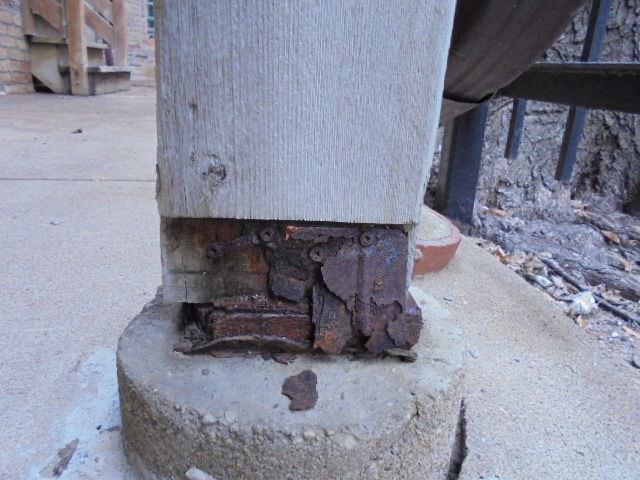

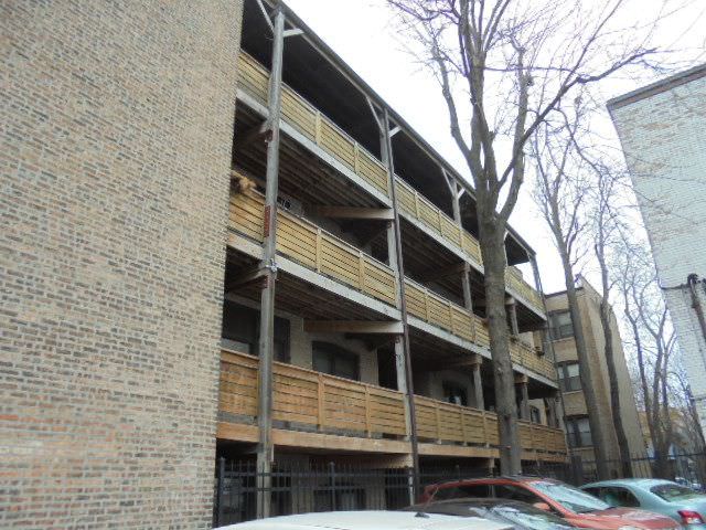

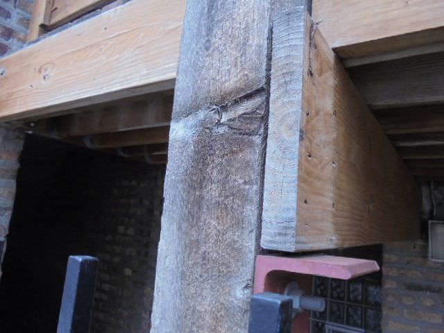

Mike Lamb Posted December 13, 2015 Report Share Posted December 13, 2015 This porch is about 10 years old and has used cedar for the main support columns. That is a first for me. Pressure treated pine is the universal support I see for wood decks. The columns are not showing any problems other than deteriorating the galvanized steel base fasteners. Cedar can be especially corrosive to galvanized steel. The Chicago Bible for decks and porches only uses Southern Pine in its examples but allows for naturally durable species of lumber. I am interested in any thoughts on reporting this. Click to Enlarge 85.66 KB Click to Enlarge 52.58 KB Click to Enlarge 49.45 KB Click to Enlarge 58.86 KB Quote Link to comment Share on other sites More sharing options...
John Kogel Posted December 13, 2015 Report Share Posted December 13, 2015 Red Cedar is fine for that. Naturally durable all the way thru, which is not true for PT wood. Re: those corroded brackets, I don't see that here in the land of Cedar, in 10 or even 20 year construction. Acid rain, maybe? I would not blame the wood for that. If Cedar was that corrosive to galvanized metal, there'd be no Cedar roofing industry. If that is White Cedar, it is said to be not as strong, but still very durable. Quote Link to comment Share on other sites More sharing options...
kurt Posted December 13, 2015 Report Share Posted December 13, 2015 If it's got all the rest of the stuff Chicago requires, I wouldn't even mention it other than describing the materials in my descriptions section. The bracket corrosion is from the salt they put on the walk. I'd probably mention that as a repair, mostly to avoid some future inspector making me look bad. Quote Link to comment Share on other sites More sharing options...
Jim Katen Posted December 13, 2015 Report Share Posted December 13, 2015 Cedar is not corrosive to galvanized metal. Cedar rots just find given enough time. I see rotting cedar almost daily. It does a lot better when you treat it every so often. Quote Link to comment Share on other sites More sharing options...

mjr6550 Posted December 14, 2015 Report Share Posted December 14, 2015 I have not problem with the cedar from a structural standpoint. I would call for replacement of the post bottoms. The heartwood of cedar is decay resistant. Unless it is old growth there is not much heartwood around. I see a lot of deteriorated cedar decking at areas where moisture is trapped. Where is can dry readily, not so much. My deck is cedar and is 25 years old. About the only decay is at the ends of decking at the perimeter of the deck. I left debris build up at the gap between the decking and the band board. Quote Link to comment Share on other sites More sharing options...

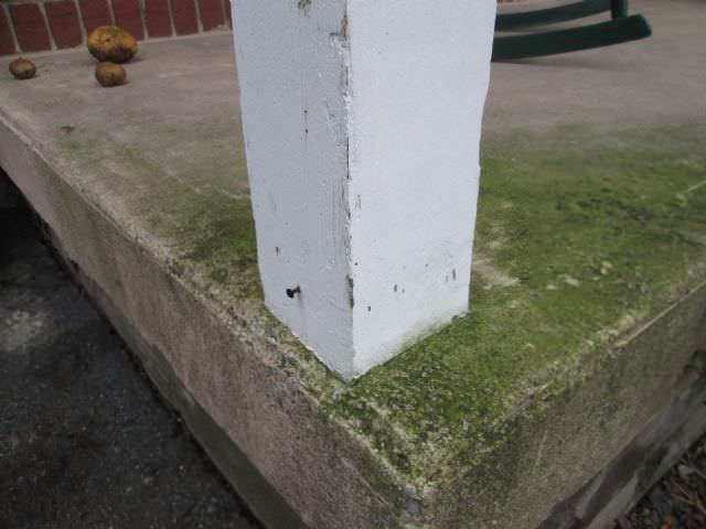

Inspectorjoe Posted December 18, 2015 Report Share Posted December 18, 2015 This thread got me thinking about my 45 year old porch posts. They're embedded in the slab. It concerned me when I bought the house 20 years ago, although there wasn't the slightest bit of softness where they enter the slab. 10 years ago, when I stripped them to repaint, I discovered they were cedar. To this day, there isn't the slightest hint of softness. I think I can finally put my concerns to rest. Click to Enlarge 44.84 KB Quote Link to comment Share on other sites More sharing options...
gtblum Posted December 18, 2015 Report Share Posted December 18, 2015 This thread got me thinking about my 45 year old porch posts. They're embedded in the slab. It concerned me when I bought the house 20 years ago, although there wasn't the slightest bit of softness where they enter the slab. 10 years ago, when I stripped them to repaint, I discovered they were cedar. To this day, there isn't the slightest hint of softness. I think I can finally put my concerns to rest. Click to Enlarge 44.84 KB I'm impressed the concrete around it hasn't blown apart after all these years. Quote Link to comment Share on other sites More sharing options...
Inspectorjoe Posted December 20, 2015 Report Share Posted December 20, 2015 I'm impressed, too. There's not much concrete on the side. It's a small ranch, but it was built by a high-end custom builder who really knew what he was doing. I still have the original kitchen, mainly because I'm cheap. The cabinets are out of style, with dark wood, but I couldn't afford to replace them with like-quality cabinets. I'm sure dark wood will be back in style some day. Quote Link to comment Share on other sites More sharing options...
Marc Posted December 20, 2015 Report Share Posted December 20, 2015 I wonder if that builder's technique was to keep the penetration of the column down to perhaps 1/2 inch so as to minimize the chance of ever breaking the concrete? Anchoring provided by some piece of steel inserted into the bottom of the column and imbedded into the concrete, steel that's less likely to crack concrete. Marc Quote Link to comment Share on other sites More sharing options...
Jim Baird Posted December 21, 2015 Report Share Posted December 21, 2015 I'm impressed, too. There's not much concrete on the side. It's a small ranch, but it was built by a high-end custom builder who really knew what he was doing. I still have the original kitchen, mainly because I'm cheap. The cabinets are out of style, with dark wood, but I couldn't afford to replace them with like-quality cabinets. I'm sure dark wood will be back in style some day. Hey Joe, The other word for "cheap" is "frugal", which in some cultures is recognized as a virtue. My daughter recently occupied a home with her new hubby that was built out in wood paneling and darker cabinet doors. She talked hubby into "pickling" doors with thinned down kilz, and they look great. Quote Link to comment Share on other sites More sharing options...
Jim Katen Posted December 21, 2015 Report Share Posted December 21, 2015 Thanks. I never see PT wood rot. A cedar trellis I built for my Dad rotted posts next to grade after about 20 yrs. I see galv nails in cedar pickets and they turn black and bleed. Premier Forest Products, whoever they are, say don't use electroplated galv fasteners. http://www.premierforestproducts.com/pages/102.pdf Are other galvanized nails and staples recommended in Western Red Cedar applications? NO! Electroplated, mechanical galvanized and untreated steel nails and staples are not recommended on any Western Red Cedar application. These types of nails and staples can rust, disintegrate, do not provide adequate holding power and react adversely with the natural preservative oils present in Western Red Cedar resulting in stains and streaks. Copper nails also react with Western Red Cedar and should not be used. They don't want you to use cheezy fasteners because they cause staining that makes their members' products look like crap. Quote Link to comment Share on other sites More sharing options...
gtblum Posted December 21, 2015 Report Share Posted December 21, 2015 I'm impressed, too. There's not much concrete on the side. It's a small ranch, but it was built by a high-end custom builder who really knew what he was doing. I still have the original kitchen, mainly because I'm cheap. The cabinets are out of style, with dark wood, but I couldn't afford to replace them with like-quality cabinets. I'm sure dark wood will be back in style some day. It is, and has been for a while! Good job waiting it out. Since I built my cabinets out of walnut, It's going to be in style around here until I'm not. [] Quote Link to comment Share on other sites More sharing options...
