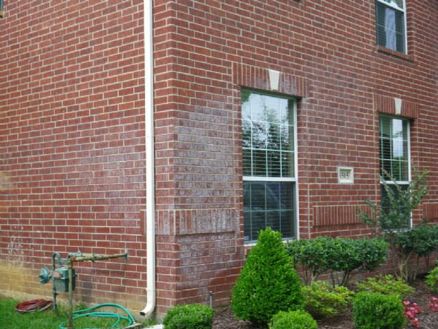

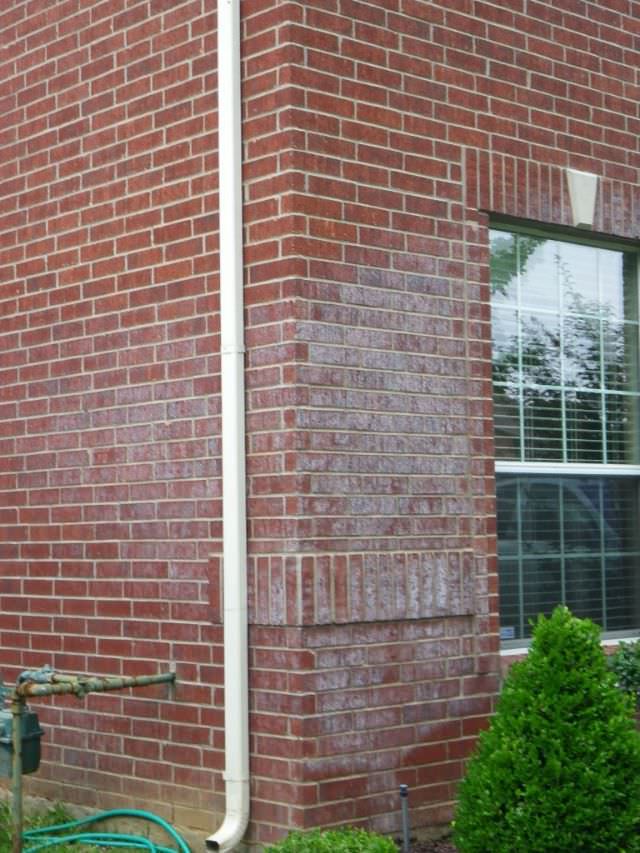

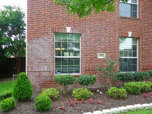

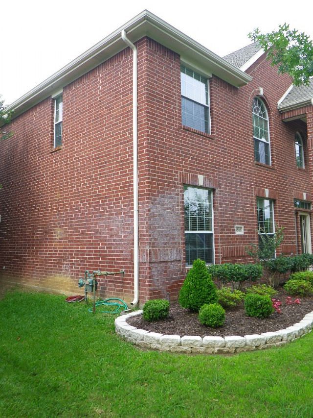

Nolan Kienitz Posted June 1, 2016 Report Share Posted June 1, 2016 Effloresence on Northeast corner of brick veneer home in D/FW from yesterday's inspection. Quite a few options left for buyer to consider. A/C condensate drain stains from prior problems as well, but not a big deal. One possibility may involve a mis-directed sprinkler system rotor head as a contributing factor. Click to Enlarge 122.22 KB Click to Enlarge 96.76 KB Click to Enlarge 153.36 KB Click to Enlarge 86.37 KB Quote Link to comment Share on other sites More sharing options...
inspector57 Posted June 1, 2016 Report Share Posted June 1, 2016 I think you nailed it, sprinkler. Quote Link to comment Share on other sites More sharing options...
Scottpat Posted June 3, 2016 Report Share Posted June 3, 2016 You can see the spray pattern going up from the top of that sprinkler head. Quote Link to comment Share on other sites More sharing options...
