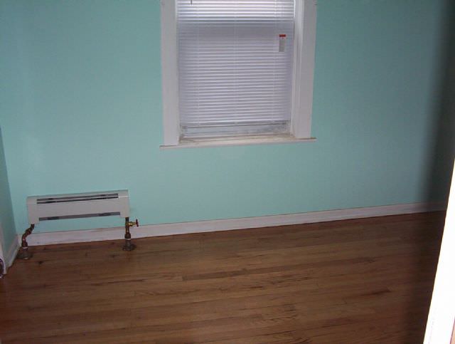

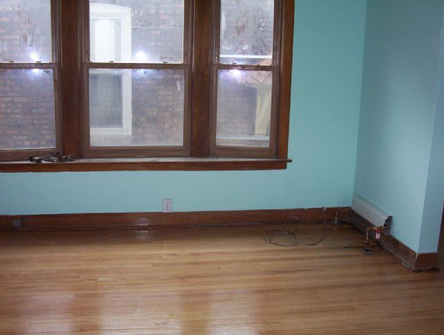

Mike Lamb Posted December 9, 2016 Report Share Posted December 9, 2016 This is taking the global warming thing a little too far. It still gets cold in Chicago. Click to Enlarge 28.24 KB Click to Enlarge 38.03 KB Quote Link to comment Share on other sites More sharing options...
kurt Posted December 9, 2016 Report Share Posted December 9, 2016 That's pretty funny. Unclear on the concept...... One doesn't remove 300 lbs. of cast iron thermal mass and 50x the radiant surface area and replace it with 2 lbs. of fin tube. Quote Link to comment Share on other sites More sharing options...
mlparham Posted December 9, 2016 Report Share Posted December 9, 2016 That's pretty funny. Unclear on the concept...... One doesn't remove 300 lbs. of cast iron thermal mass and 50x the radiant surface area and replace it with 2 lbs. of fin tube. One can and will. Quote Link to comment Share on other sites More sharing options...
Marc Posted December 9, 2016 Report Share Posted December 9, 2016 There would have to be active components (fan/controller) to duplicate the thermal dissipation of the radiator that was there before. It definitely calls for engineering. Anyway, I get the gist of the thread. It's another amusing DIY fumble. Marc Quote Link to comment Share on other sites More sharing options...
kurt Posted December 9, 2016 Report Share Posted December 9, 2016 One can and will. True enough. Interestingly, I hardly ever see stuff this stupid. Chicago is big on hydronic heating; most people get it. It's not common to see stuff that idiotic around here. Quote Link to comment Share on other sites More sharing options...
