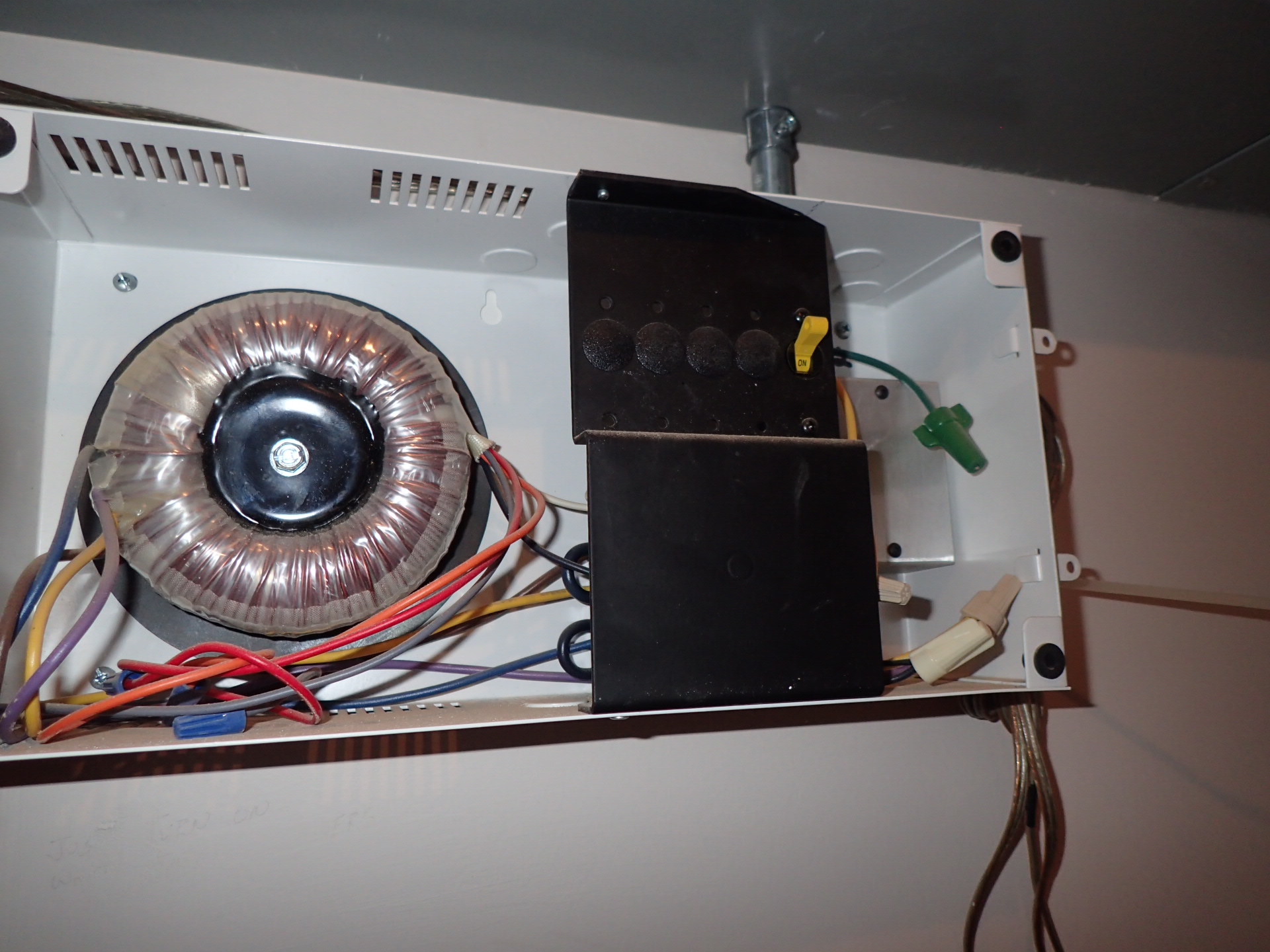

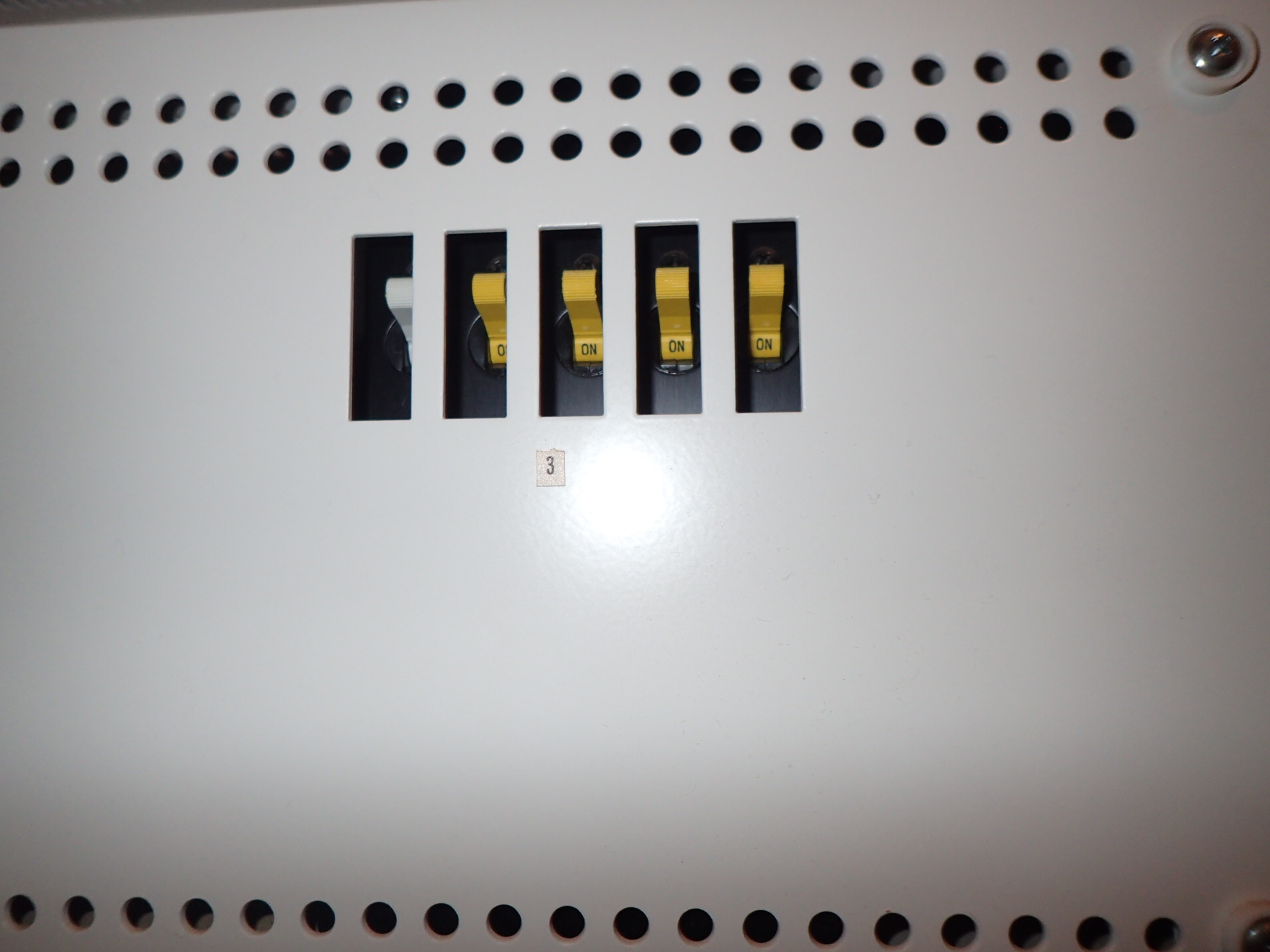

Mike Lamb Posted July 7, 2017 Report Share Posted July 7, 2017 What do you suppose all the switches might be for? This was part of a 2500 ft.² condo in a high-rise. All the wires come out of a gutter that I did not open. Link to comment Share on other sites More sharing options...
Marc Posted July 7, 2017 Report Share Posted July 7, 2017 (edited) Whatever it is...that's a toroidal transformer in there, common in audio circuits because of its superior performance. The switches might be for choosing a particular toroidal tap over another, say, for impedance matching, like 8 ohm, 16 ohm speakers, etc. Edited July 7, 2017 by Marc Link to comment Share on other sites More sharing options...
John Kogel Posted July 9, 2017 Report Share Posted July 9, 2017 I see speaker wires and that matching transformer with multiple taps. An over-the-top, built-in sound system is a good guess. I started to guess that it was part of an alarm system but reread the description where you say this equipment services just one apartment. Another example of lunatic megalomania. Link to comment Share on other sites More sharing options...
Jim Katen Posted July 9, 2017 Report Share Posted July 9, 2017 Why five of them? That's way beyond "over the top." Link to comment Share on other sites More sharing options...
