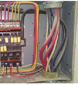

JimAntoni Posted February 25, 2020 Report Share Posted February 25, 2020 Hi, We have to replace a subpanel in the apartment and it turns out there are live wires (on the right hand side) going to other apartments. What is the correct way to replace the box without cutting these wires to other units? They are trapped in the knockout. If we cut the existing box in half and leave those wires on the side, will it affect the grounding to other units? Thanks for your help and time. Jim Link to comment Share on other sites More sharing options...

Marc Posted February 25, 2020 Report Share Posted February 25, 2020 Those wires aren't supposed to be in there in the first place. Punt this problem to the HOA, let them hire an electrician to remove those wires. Link to comment Share on other sites More sharing options...
JimAntoni Posted February 25, 2020 Author Report Share Posted February 25, 2020 Thank you both for the reply. I am getting the proposals and one of them is just to leave them alone and put the new one in the closet next to it. Is it ok to install an electrical panel inside a walk-in closet? Link to comment Share on other sites More sharing options...
Chad Fabry Posted February 25, 2020 Report Share Posted February 25, 2020 35 minutes ago, JimAntoni said: Thank you both for the reply. I am getting the proposals and one of them is just to leave them alone and put the new one in the closet next to it. Is it ok to install an electrical panel inside a walk-in closet? No it is not. But that wouldn't stop the guy that installed the current set-up. Link to comment Share on other sites More sharing options...
Jim Katen Posted February 26, 2020 Report Share Posted February 26, 2020 If the existing enclosure is large enough, you can get a new panelboard that will fit inside. Just pull out the nasty old panelboard and screw in the nice new one. Your electrician should be able to get one from his supplier. Link to comment Share on other sites More sharing options...
Marc Posted February 26, 2020 Report Share Posted February 26, 2020 2 minutes ago, Jim Katen said: If the existing enclosure is large enough, you can get a new panelboard that will fit inside. Just pull out the nasty old panelboard and screw in the nice new one. Your electrician should be able to get one from his supplier. What about mating the new cover to the old box? The screws have to line up. What are the chances? Link to comment Share on other sites More sharing options...
Jim Katen Posted February 26, 2020 Report Share Posted February 26, 2020 8 minutes ago, Marc said: What about mating the new cover to the old box? The screws have to line up. What are the chances? https://www.eaton.com/ecm/groups/public/@pub/@electrical/documents/content/sa00406001e.pdf As I understand it, you screw an oversized picture-frame plate to the wall. It's inner opening is smaller than the original box opening. Then the new deadfront cover screws to the picture-frame plate. Link to comment Share on other sites More sharing options...
Marc Posted February 26, 2020 Report Share Posted February 26, 2020 11 minutes ago, Jim Katen said: https://www.eaton.com/ecm/groups/public/@pub/@electrical/documents/content/sa00406001e.pdf As I understand it, you screw an oversized picture-frame plate to the wall. It's inner opening is smaller than the original box opening. Then the new deadfront cover screws to the picture-frame plate. Wow. Link to comment Share on other sites More sharing options...
JimAntoni Posted February 26, 2020 Author Report Share Posted February 26, 2020 Thank you Jim. That's a great idea. The width of the current enclosure is 14 inch. Excluding the right hand side pipe/lines, that leaves the new one with 9 inch. I cannot extend to the left as it already next to a stud. Originally when I was thinking cutting the box in half, I was thinking using this one as it is 8.88 inch wide. https://www.homedepot.com/p/Square-D-QO-100-Amp-8-Space-16-Circuit-Indoor-Flush-Mount-Main-Lug-Load-Center-QO816L100FCP/100148341 Now it looks like I can only use RSCH12L125N on your back sheet as current one has 12 breakers. Is it okay to use this one but with N on UL67 listed? Thx. Link to comment Share on other sites More sharing options...
Jim Katen Posted February 26, 2020 Report Share Posted February 26, 2020 That's a question for your local building department. I might be wrong, but I think that you can fit up to 24 tandem breakers in that panel - ask Eaton. And, by the way, that assumes that your building department is ok with having your neighbor's feeder passing through your panel. Link to comment Share on other sites More sharing options...
