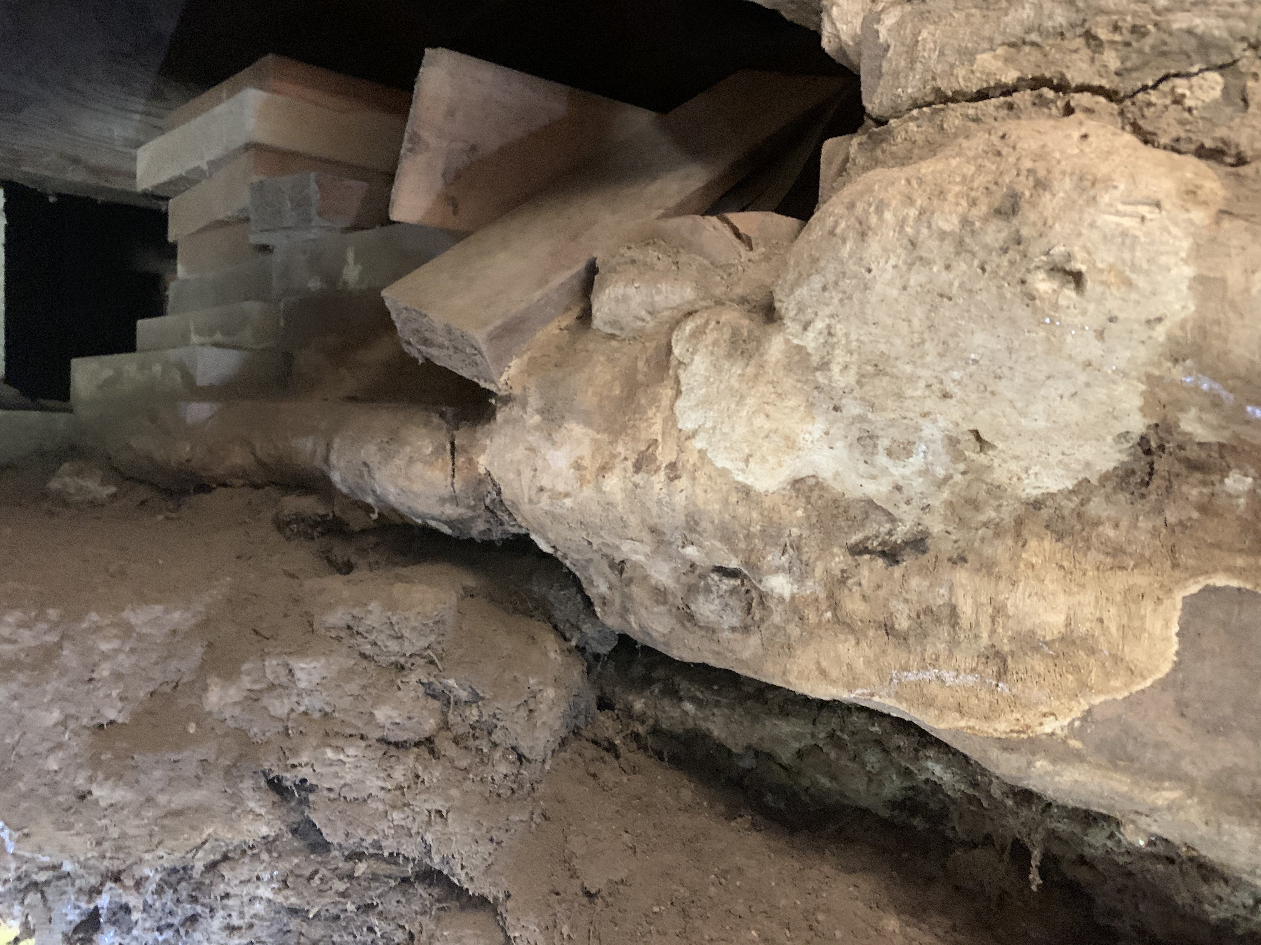

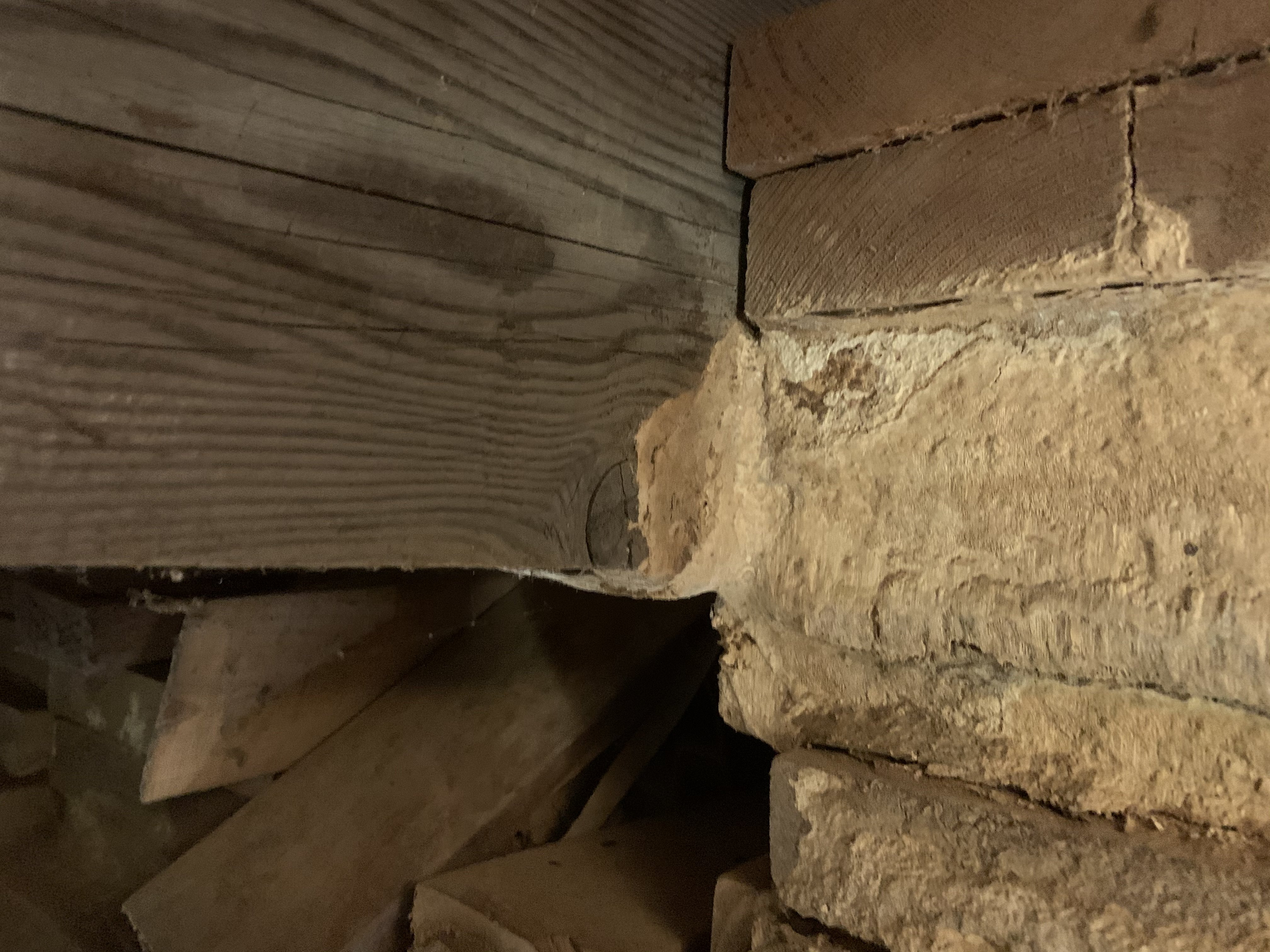

Trent Tarter Posted August 19, 2020 Report Share Posted August 19, 2020 I'm a WA State licensed pest inspector so I am familiar with wood destroying insects and typical conditions. I found this strange coating on wood in crawlspace, not able to determine what it's from, fungi growth? It was real firm when probed. This place is a little cabin located in the blue mountains. Link to comment Share on other sites More sharing options...
Jim Katen Posted August 20, 2020 Report Share Posted August 20, 2020 It looks like one of those really hard mushroom thingies that you just about need a table saw to cut through. I assume you told them to pull all that crap out of there. Link to comment Share on other sites More sharing options...
Trent Tarter Posted August 20, 2020 Author Report Share Posted August 20, 2020 7 minutes ago, Jim Katen said: It looks like one of those really hard mushroom thingies that you just about need a table saw to cut through. I assume you told them to pull all that crap out of there. Yes I told them to remove it, however it's the least of the concerns. Place has a substandard post and pier foundation with numerous issues, significant wood rot. Link to comment Share on other sites More sharing options...
Adam Frers Posted March 5, 2021 Report Share Posted March 5, 2021 From your photos, it looks similar to wood destroying fungus also known as sporing fungal growth. Not uncommon for it to start on the cellulose and transfer to the masonry. We find many iterations of this here in North Carolina and it typically is the direct result of persistent moisture contact, or elevated levels of moisture below the home. You may find that the wood still feels sound when probed, but will quickly exhibit wood rot once the moisture source is eliminated. Link to comment Share on other sites More sharing options...
hausdok Posted March 6, 2021 Report Share Posted March 6, 2021 It's Poria Incrassata - I like to refer to it as A.I.D.S. for wood. Link to comment Share on other sites More sharing options...
