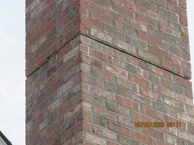

Marc Posted September 10, 2020 Report Share Posted September 10, 2020 (edited) This is a prefab fireplace with a metal flue inside a brick chimney. 1994 construction. The crack completely circumscribes the chimney with a steady width all the way around. The mortar adheres overhead in most places but adheres to the bottom in a few places. Never seen this before. We had hurricane Laura with winds over 100 mph two weeks ago, but nothing else in this subdivision seems to have taken any damage. Any idea what's going on? I've until 9 AM tomorrow to submit this report. Thanks in advanced. Edited September 10, 2020 by Marc Quote Link to comment Share on other sites More sharing options...
John Kogel Posted September 10, 2020 Report Share Posted September 10, 2020 I have seen similar where a masonry flue liner would seem to be supporting the upper section while the lower section settled. In one case where I knew the owner, we filled the gap with fresh mortar and made sure the liner was intact and tight. Nothing bad happened that time, but the crack was more of a fine line. For yours, it looks like a repair job for an experienced professional mason. That would be caused by settlement of the chimney pad, or expansion of the steel liner possibly, not storm related, IMO. Quote Link to comment Share on other sites More sharing options...
Marc Posted September 10, 2020 Author Report Share Posted September 10, 2020 30 minutes ago, John Kogel said: I have seen similar where a masonry flue liner would seem to be supporting the upper section while the lower section settled. In one case where I knew the owner, we filled the gap with fresh mortar and made sure the liner was intact and tight. Nothing bad happened that time, but the crack was more of a fine line. For yours, it looks like a repair job for an experienced professional mason. That would be caused by settlement of the chimney pad, or expansion of the steel liner possibly, not storm related, IMO. I guess it's possible that a flue liner is present and that a prefab fireplace has been inserted into a masonry firebox. Quote Link to comment Share on other sites More sharing options...
Jim Katen Posted September 10, 2020 Report Share Posted September 10, 2020 5 hours ago, John Kogel said: I have seen similar where a masonry flue liner would seem to be supporting the upper section while the lower section settled. In one case where I knew the owner, we filled the gap with fresh mortar and made sure the liner was intact and tight. Nothing bad happened that time, but the crack was more of a fine line. For yours, it looks like a repair job for an experienced professional mason. That would be caused by settlement of the chimney pad, or expansion of the steel liner possibly, not storm related, IMO. I once owned a house where that happened. The terra cotta liners were supporting the upper section of the chimney. I never patched it, just left it like that. For all I know it's still like that. Quote Link to comment Share on other sites More sharing options...
Marc Posted September 10, 2020 Author Report Share Posted September 10, 2020 36 minutes ago, Jim Katen said: I once owned a house where that happened. The terra cotta liners were supporting the upper section of the chimney. I never patched it, just left it like that. For all I know it's still like that. I'm somewhat inclined to recommend patching to help keep rainwater out. Quote Link to comment Share on other sites More sharing options...
